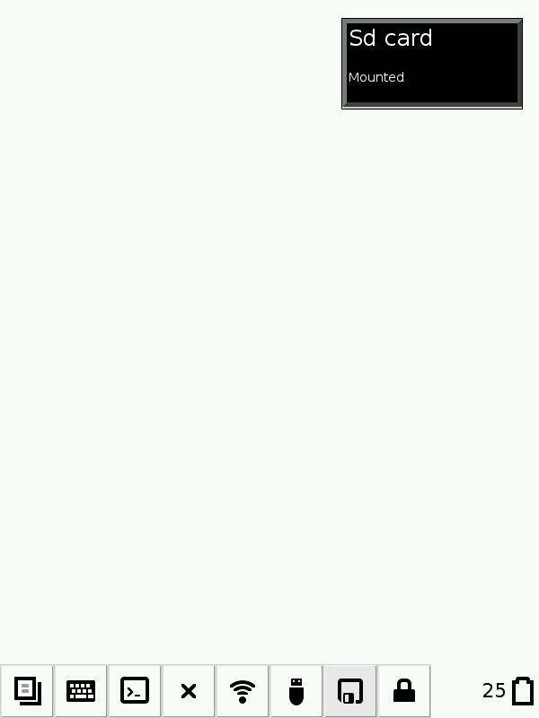

Hi everybody,
just passing by to say that thanks to marek I too have turned my kobo into a linux tablet.
I have been using it for more or less a month and in the meanwhile I edited the original image.
Mostly fixes (e.g. the blinking led) and customization (e.g screen/scripts/vertical orientation), but more importantly I made a new window manager, mostly because I was not pleased in one way or another with any one I tried.
If anyone is interested I put the source on a github page, and the full image on dropbox.
Good reading!
