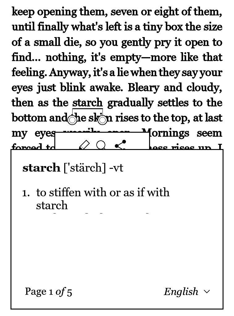

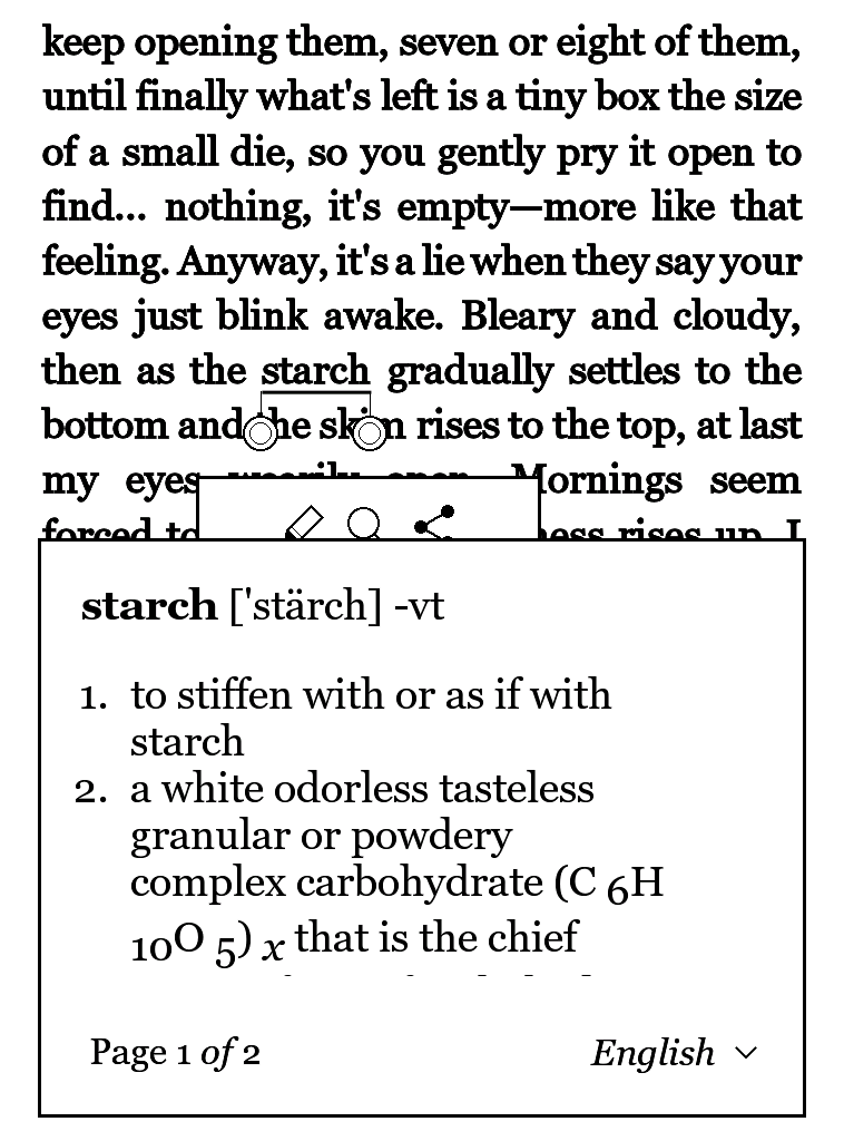

In libnickel.so.1.0.0 I replaced
"Your search for “%1” did not match any words in the dictionary. The closest match was “%2”."
with 115 spaces. This saves a lot of space in dictionaries for inflecting languages (Italian etc.), because with these languages this message otherwise keeps popping up most of the time. And this works even if your Kobo's user language is NOT English! In the same way one can remove the copyright note which some dictionaries display at the end of every entry.

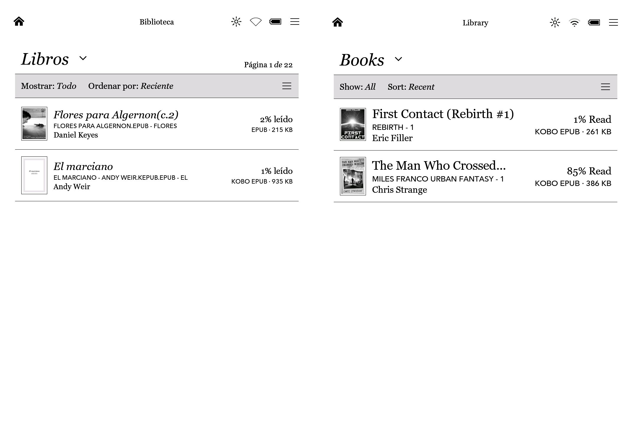

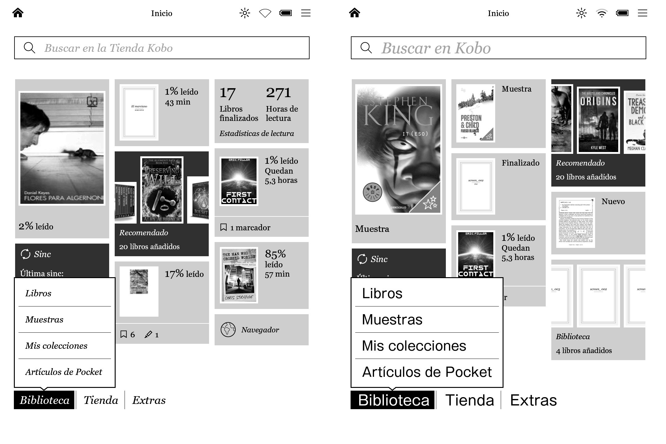

This is my settings. I used only five patches and I modified values to adjust the size of text menus and dictionary, change the font and change italic format.
My changes in the patches are marked in red.
ID:	135231   Click image for larger version
ID:	135232   Click image for larger version

For example, Glo, FW 3.13.1, changes marked in red. For clarity, I changed only the height.
Change 1 (in nickel):
<patch>
name=?
enabled=true
action=replace_string
position=2D0215
oldpart=#InlineDictionaryView {\n\tmin-width: 500px;\n\tmax-width: 500px;\n\tmin-height: 220px;\n\tmax-height: 220px;\n}\n
oldpart=#InlineDictionaryView[qApp_deviceIsPhoenix="true"] {\n\tmin-width: 650px;\n\tmax-width: 650px;\n\tmin-height: 280px;\n\tmax-height: 280px;\n}\n
oldpart=#InlineDictionaryView[qApp_deviceIsDragon="true"] {\n\tmin-width: 980px;\n\tmax-width: 980px;\n\tmin-height: 350px;\n\tmax-height: 350px;\n}\n
newpart=#InlineDictionaryView {\n\tmin-width: 500px;\n\tmax-width: 500px;\n\tmin-height: 220px;\n\tmax-height: 220px;\n}\n
newpart=#InlineDictionaryView[qApp_deviceIsPhoenix="true"] {\n\tmin-width: 650px;\n\tmax-width: 650px;\n\tmin-height: 480px;\n\tmax-height: 480px;\n}\n
newpart=#InlineDictionaryView[qApp_deviceIsDragon="true"] {\n\tmin-width: 980px;\n\tmax-width: 980px;\n\tmin-height: 350px;\n\tmax-height: 350px;\n}\n
combineparts
</patch>
Change 2 (in libnickel):
<patch>
name=?
enabled=true
position=BF5688
oldpart=#textEdit {\n\tmin-height: 150px;\n\tmax-height: 150px;\n\tmin-width: 515px;\n\tmax-width: 515px;\n}\n\n
oldpart=#textEdit[qApp_deviceIsPhoenix="true"] {\n\tmin-height: 190px;\n\tmax-height: 190px;\n\tmin-width: 550px;\n\tmax-width: 550px;\n}\n\n
oldpart=#textEdit[qApp_deviceIsDragon="true"] {\n\tmin-height: 235px;\n\tmax-height: 235px;\n\tmin-width: 930px;\n\tmax-width: 930px;\n}
newpart=#textEdit {\n\tmin-height: 150px;\n\tmax-height: 150px;\n\tmin-width: 515px;\n\tmax-width: 515px;\n}\n\n
newpart=#textEdit[qApp_deviceIsPhoenix="true"] {\n\tmin-height: 390px;\n\tmax-height: 390px;\n\tmin-width: 550px;\n\tmax-width: 550px;\n}\n\n
newpart=#textEdit[qApp_deviceIsDragon="true"] {\n\tmin-height: 235px;\n\tmax-height: 235px;\n\tmin-width: 930px;\n\tmax-width: 930px;\n}
combineparts
</patch>
First picture shows effect of change 1. The second shows effect of changes 1 and 2.
