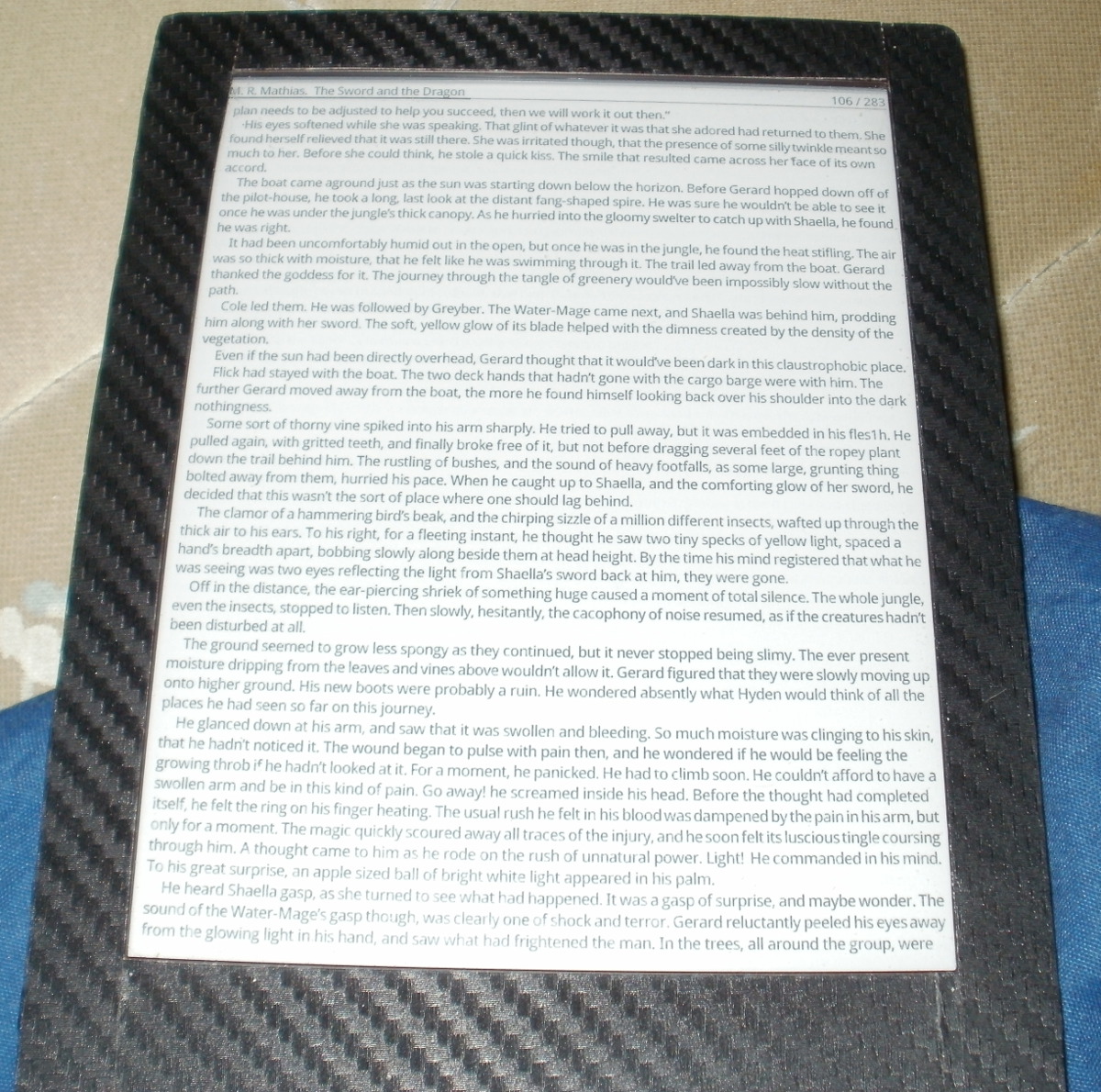

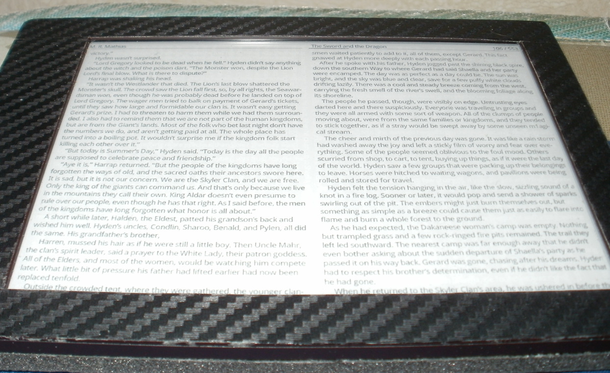

Another KoReader response to the users issues that are ignored by Kobo, Full Screen: and Landscape:
Luck;
Ken
