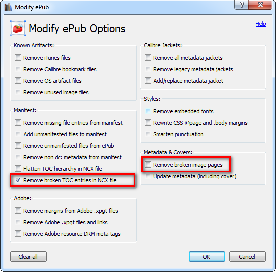

New beta version
A few new features for people to play with and offer feedback on (plus the fix for the modified date column issue reported above):
  • Remove broken cover images - calibre epub conversions will frequently result in leaving behind an html page that contains nothing but a broken image link on it. This option searches for specifically that situation (an html page containing an image tag that is broken) and if there is no other text in the body of the page then the page is removed completely from the epub.
  • Remove broken TOC entries in NCX - a partner for a new feature in Quality Check, which identifies broken links in your TOC and removes the entry in the NCX file. Again these are often caused by calibre conversions due to issues with its covers logic but could also be from careless tweak/Sigil editing.
As always, feedback welcomed.
