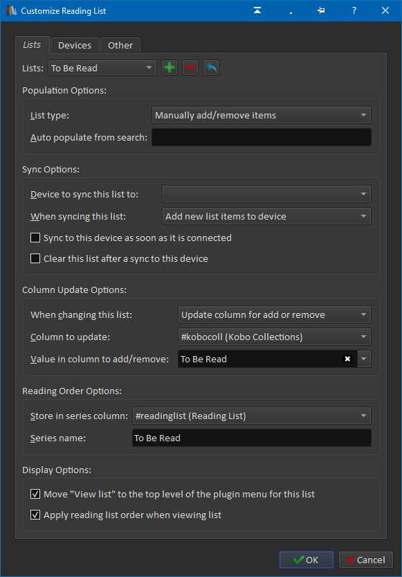

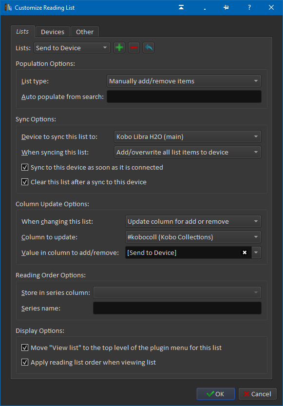

I only sync the Send to Device list, but here's my settings:
Name:	2022-03-30 18_53_23-Customize Reading List.png
Name:	2022-03-30 18_51_59-Customize Reading List.png
It shouldn't duplicate unless the save path has changed, so that's a bit odd.

@criscros: For my send-to-device Reading Lists, I use "Add/Overwrite all list items to device" and have "Clear this list after a sync to this device" checked. With this, I add any new or updated books to the device when it connected and the only books in the list are those waiting for the device to be connected.
For the duplicates, that means that something has changed. It could be a change in the metadata that is used by the save template. The default save template includes the title and author, so any change in those will result in a different file name being generated and a second copy when the book is put on the device. Another common reason for duplicates is changing between the builtin KoboTouch driver and the KoboTouchExtended driver. The latter sends books as kepubs which means the filename is different and will result in a second copy if you swap between them.
