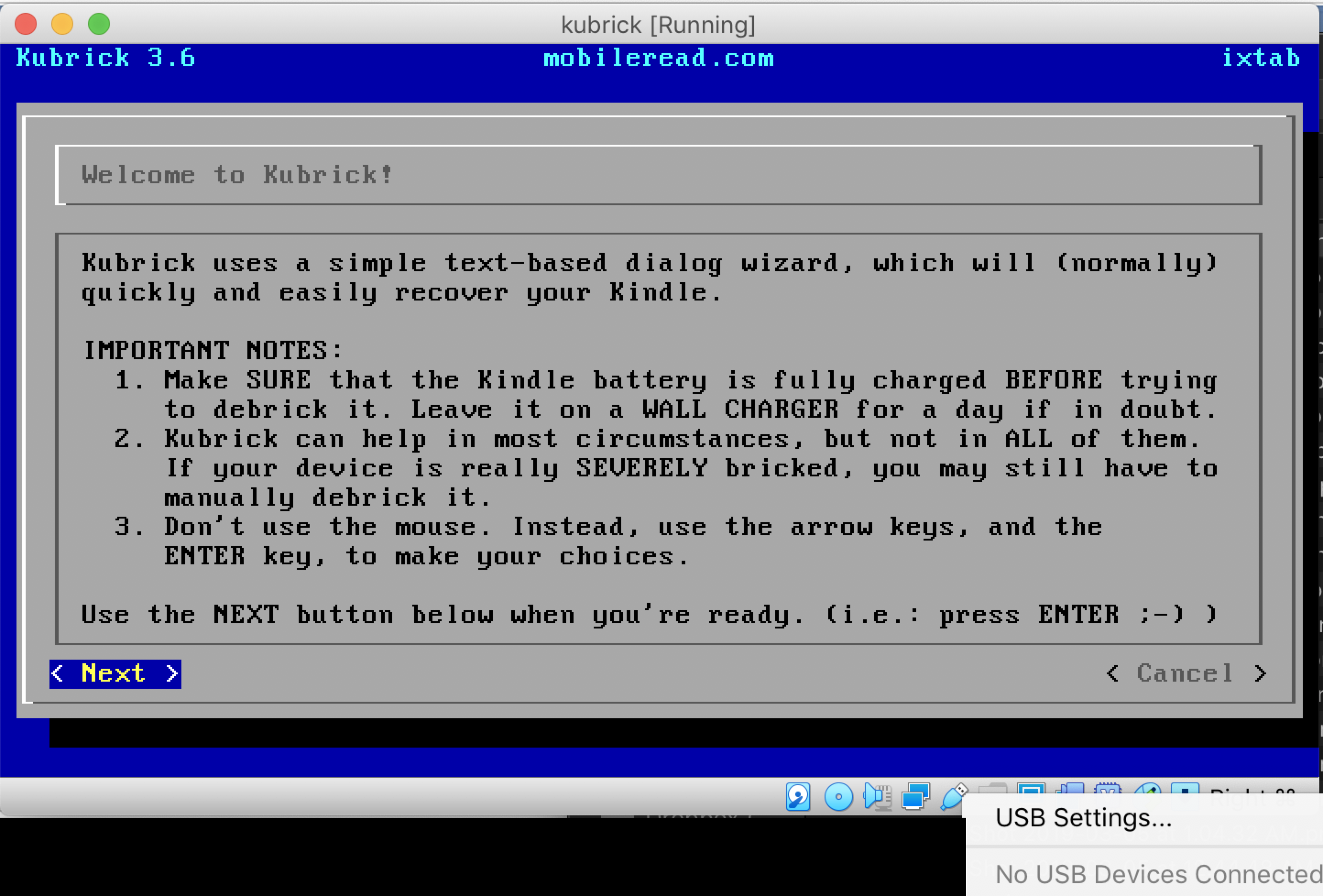

Not sure which VM you are using, but make sure you check/add whatever new USB device showing up under the setting during the process.
Name:	Screen Shot 2019-04-20 at 10.40.36 PM Redacted.png
fS6pl9buyne is offline   Reply With Quote

Yeah , this is the confusing keypoint.
I used virtualbox6.0.6 on Debian9 with my samsung laptop.
My guest machine can recognize the kindle when it in "normal mode" and "magic key mode ",but when the kubrick trying to turn it into "fastboot mode",the machine would lost the device.
So I think maybe is something wrong with the usb driver on debian .
I'm thinking about make a CD to do a last try or buy a new kindle,casue the new kindle is not so expensive.
