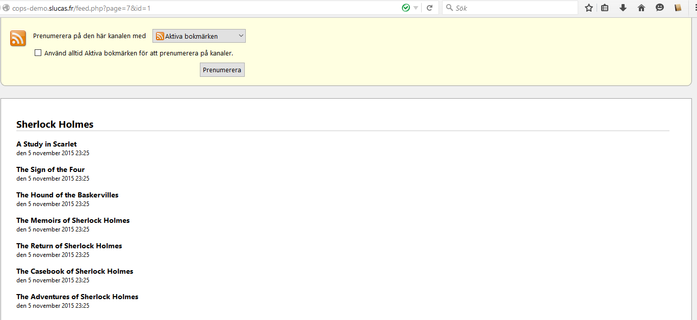

Ive attached a picture how it looks in firefox after installing the plugin but i still can see a wayto download the books. As for permissons ive cheacked with both the OMV UI and with WinSCP and it is sett to alow read/write

in firefox now try: http://cops-demo.slucas.fr

that works like a charm
however if i do the same on my server when i chose a book and press the epub icon i get
404 Not Found
nginx/1.2.1
but if i press the eye it will open in a new tab and i can read it.
