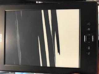

It seems, then, that my Kindle can boot in USB Recovery, fastboot and diags modes, but the screen is frozen. !
Same here. Every steps works fine, but after flashing and resetting the sreen hangs on this "broken" black/white thing. I can't see the diag menu.
Eventually the diag menu is THERE but I just can't see it? If so: Could someone please give me the clicks to go in USBNet (e.g. 3 x down -> Enter -> 8 x down -> Enter and so on...)
