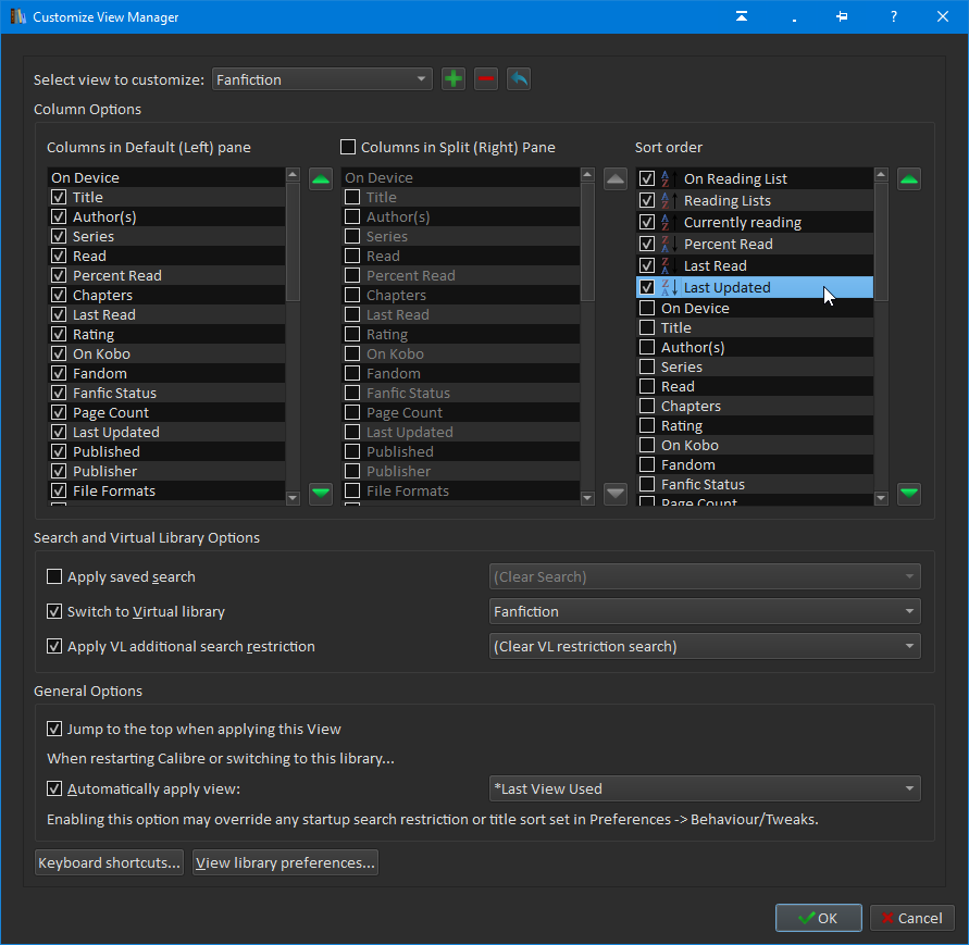

I have my reading lists set to modify a series column and to add/remove a value from tag-like #kobocoll column.
1. With view manager, switch to a view. If it matters, most of my views have the reading list series column sorted near the top.
2. Add or remove a book from a reading list.
3. Select that book.
4. Press F5 to refresh. If the bug occurs, the book drops to the bottom of the list regardless of where it ought to be in the list. Changing views doesn't fix this.
I notice it happens a bit more when a device is plugged in.

I have my reading lists set to modify a series column and to add/remove a value from the #kobocoll column.
"Switch to a view" is a bit too generic, since a primary use for Views is to change the sort order.
At no point here do you say that you're invoking Reading List's 'View list' function? That's when VM changes the 'marked' values to match the list.
I'm not familiar with an 'F5' to refresh in Calibre. Did you assign that to something? Searching Calibre's key config for 'Refresh' only finds QuickView refresh.
This. The reading list plugin always changes the sort order so that it sorts by the marked field. This is how it can get the books in order. (the books are marked: reading_list_default_0000, reading_list_default_0001, reading_list_default_0002 ... etc).
Any time you use the View Manager it will mess up the sort for the reading list plugin.
Edit: If you must use the View Manager Plugin, use before you show the list, not after.

No, I don't use View List at all. I
F5 for refresh was added a couple of versions ago. It's called "Re-apply current sort."
Attached are three screenshots of the views I see it happening most commonly under.
Reading Lists is my series-like, and "on reading list" is a composite that returns 'true' when that column is populated - otherwise I'd have to use descending order to keep it at the top of the list.
Currently reading's another composite.
Last read, last updated, date are all dates.
Percent read is integer.
On Kobo is a boolean.
On Device is built in - it only works when a device is actually plugged in.
Name:	2021-07-24 16_48_40-Customize View Manager.png
ID:	188329   Click image for larger version
Name:	2021-07-24 16_48_54-Customize View Manager.png
ID:	188330   Click image for larger version
Name:	2021-07-24 16_48_59-Customize View Manager.png

If you are not using the "view list" then the reading list plugin cannot affect the sorting. Not directly at least. It can only affect the sorting — indirectly — by updating columns that are in your sort order. And the books going to the bottom are probably just following the sort order defined by your view.
If you apply a new view that does not include the following columns: ( On reading list, reading lists ) the books will probably stop going to the bottom.

Unfortunately, if I switch to the "Series" view (which only sorts by series) and switch to all books, the affected books are still at the bottom of the list.

If you switch to a view that only sorts by one column (series column), what happens is that it pushes that column to the top of the sort order, while the first few columns of the previous view (depending on the value of maximum_resort_levels tweak) are still active when the books have the same value for the first column (series column).
Without seeing the data it is harder to know what is happening. But you can see for your self the current sort order, and examine whether the books follow that same order by using the following action in Action Chains (start in debug mode and it will print sort order to the console):
from calibre.utils.config import tweaks
from calibre_plugins.action_chains.actions.base import ChainAction
class SortingInfo(ChainAction):
    name = 'Sorting Info'
    def run(self, gui, settings, chain):
        db = gui.current_db
        sort_history = gui.library_view.get_state().get('sort_history', [])
        max_sort_levels = tweaks['maximum_resort_levels']
        print('DEBUG: sort_order: {}'.format(sort_history[:max_sort_levels]))
