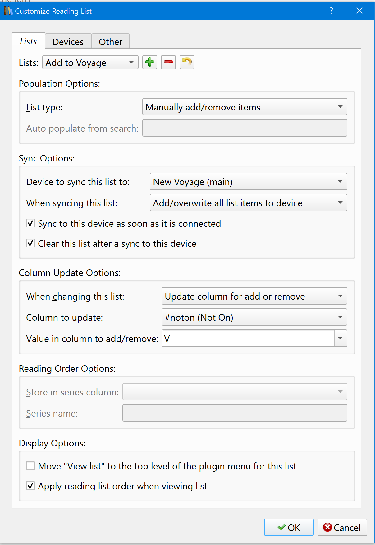

Question: Is it intended that a clear-on-sync list have the series column options grey out?
Old 03-11-2021, 01:37 AM   #1044
davidfor
Posts: 24,905
Karma: 47303826
Location: Sydney, Australia
I think so. To me, those options are a workaround for putting the a reading list order somewhere that can be seen in other parts of the calibre interface. You can sort or search on that column.
The other thing is that the series column is updated when you add or remove the book from the list. For a clear-on-sync list, the book is removed from the list when it is queued to be sent. And that removes the book from that series. That means that when the book is actually sent, the series info will always be empty.
Old 03-11-2021, 02:51 AM   #1045
ownedbycats
Custom User Title
ownedbycats's Avatar
Posts: 11,633
Karma: 81412473
Join Date: Oct 2018
That makes sense. I just have it add a tag to #kobocoll instead (since it clears out on sync, KoboTouchExtended never gets a chance to make the collection on device) for column icon purposes.
