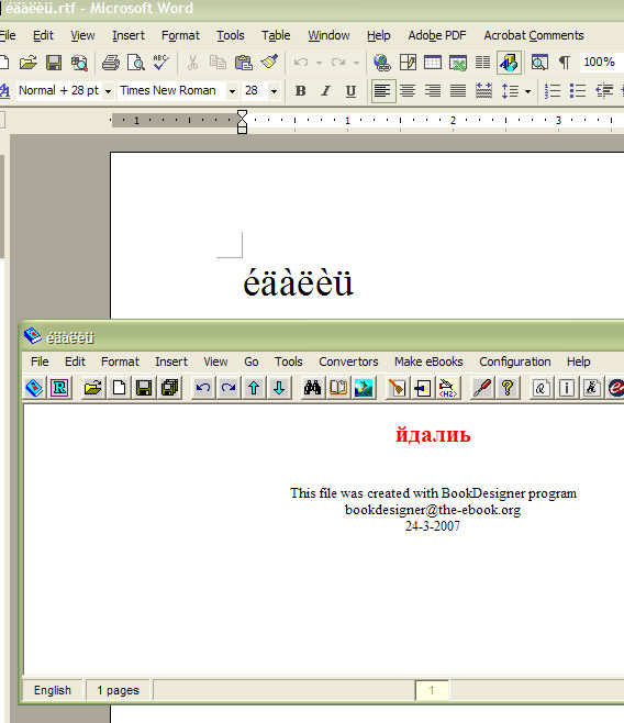

Old 03-24-2007, 08:56 AM   #105
diabloNL
Gadget Force®
diabloNL plays well with othersdiabloNL plays well with othersdiabloNL plays well with othersdiabloNL plays well with othersdiabloNL plays well with othersdiabloNL plays well with othersdiabloNL plays well with othersdiabloNL plays well with othersdiabloNL plays well with othersdiabloNL plays well with othersdiabloNL plays well with others
diabloNL's Avatar
Posts: 705
Karma: 2733
Join Date: Jun 2006
Location: The Netherlands
Device: Sony PRS-300 + Cybook with funny screen :P
Does anyone know why some characters are transformed in Russian characters?
Also the "&" sign disappears when importing a RTF file and if you add it yourself to BD it will print it as "&amp;" in the LRF file. When I import "é" in BD he will show it as "й" and when it's a LRF file it will show it as "&-#233;"
See picture:
