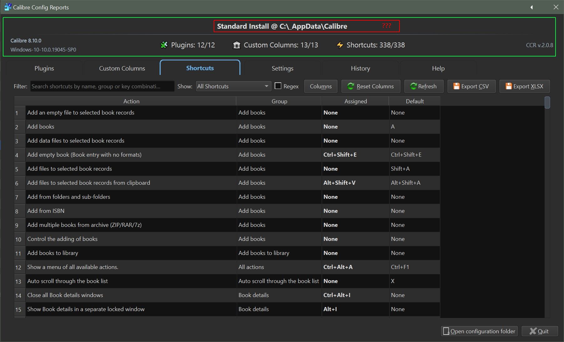

Name:	Screenshot 2025-09-10 182809.jpg
It would be quite useful to be able copy the info in the green box to the Clipboard - as text.
Where are you getting the "C:\_Appdata\Calibre" and what do think it designates?
Calibre 8.10.0 is installed in the default location:- C:\Program Files\Calibre2

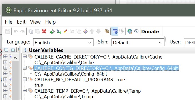

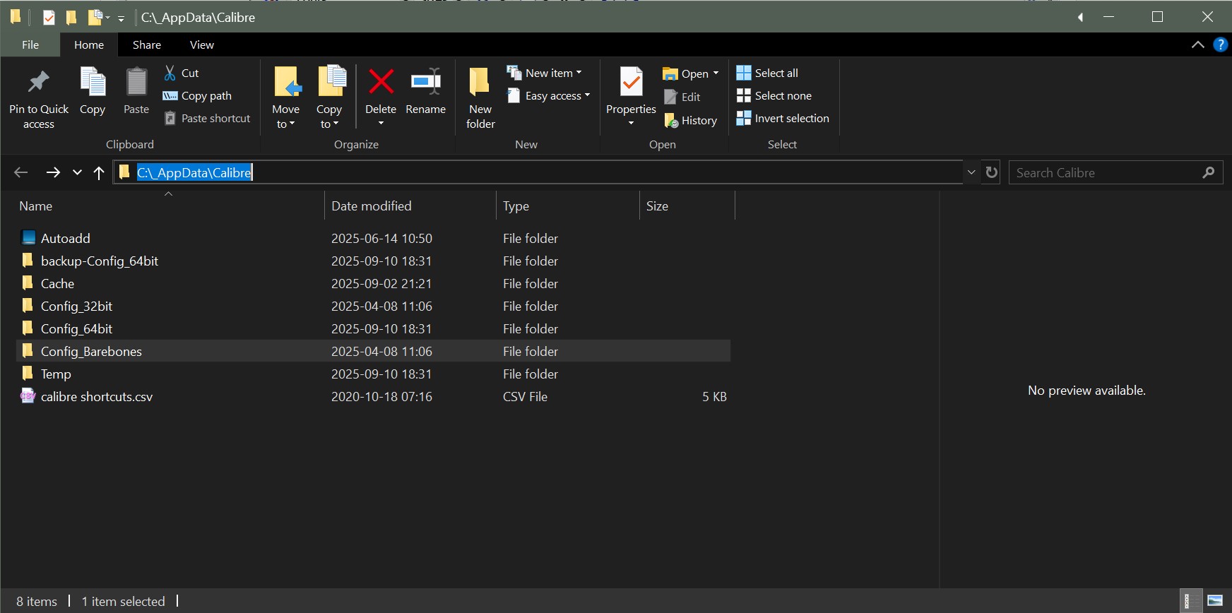

The C:\_Appdata\Calibre folder is where I store the Calibre 'control' data :
Name:	Screenshot 2025-09-10 185512.jpg
Some of which is referenced by Environment Variables
Name:	Screenshot 2025-09-10 190217.jpg

In my case it would be more meaningful if that line read:
Installed @ C:\Program Files\Calibre2 using C:\_AppData\Calibre\Config_64bit

Original intent was that the location at the top would facilitate access to config folder, either on Portable or Standard installs...
(Of course, also intended to give user more visibility of what Calibre install they're working on.)
Since the open configuration folder was implemented, I choose to remove the clickable path and trim the Appdata path on Standard Installs.
Not sure if displaying the Calibre standard install location would be useful, will think about it. New version will address some improvements you asked before

i think i can display for Standard Installs just the caption "Standard Install" (this is enough to differentiate from portable instances)..

I have published version 2.0.9:
- on standard calibre installs (OS wide installations as opposed to portable), location info displays "Default Install"
- custom columns tab: added web search template field
- shortcuts tab: user defined shorcuts option added to dropdown chooser; table formatting for those is emphasised.
- plugins tab: added 'Is disabled' column (note: only some plugin types can be disabled in Calibre e.g. metadata sources)
- plugins tab: On the dropdown selector, moved 'Not in index' item to first option, followed by 'Extend calibre generally".
- copy info context menu and respective shortcut have been added (main dialog header information data, as requested)
