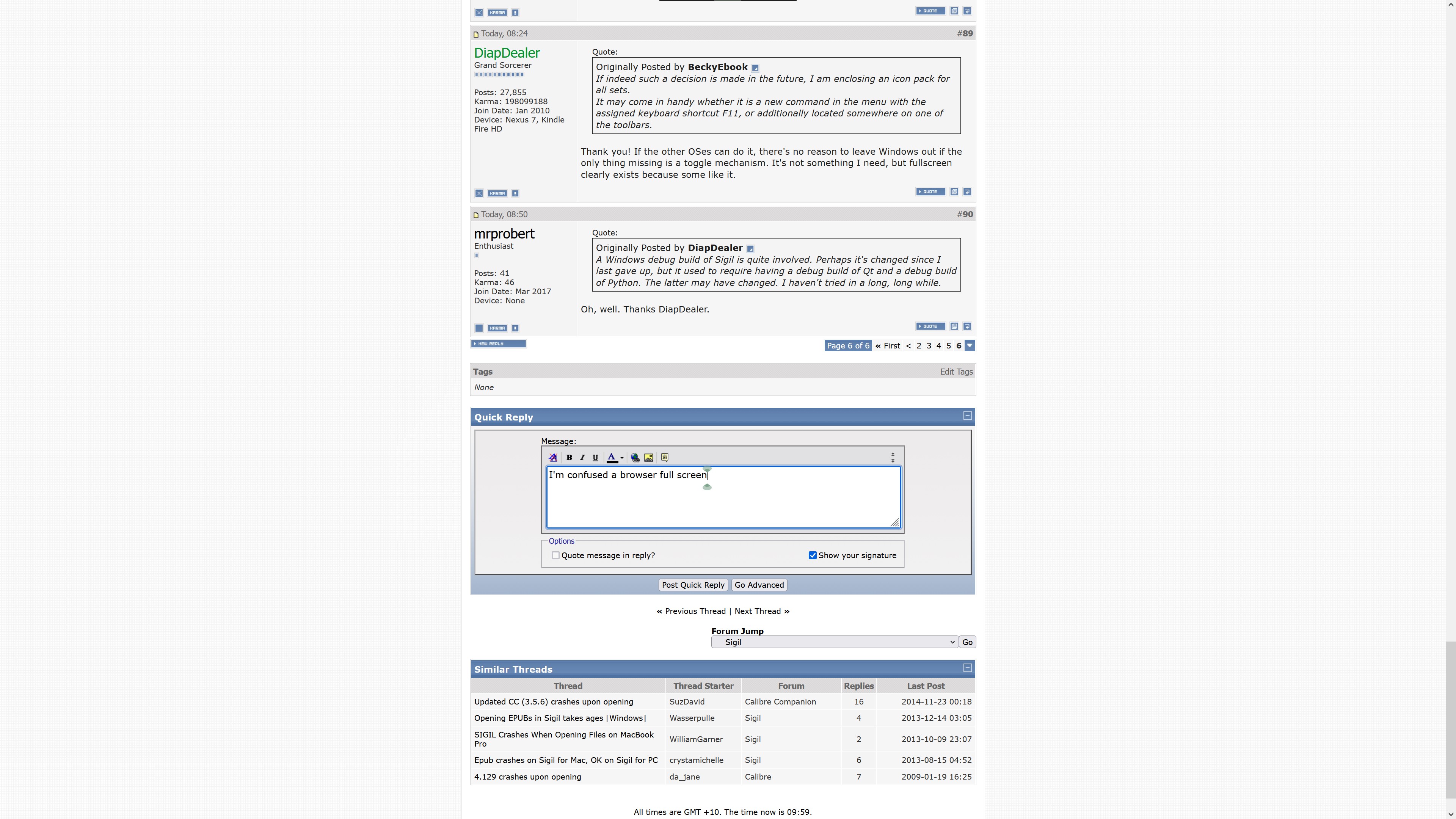

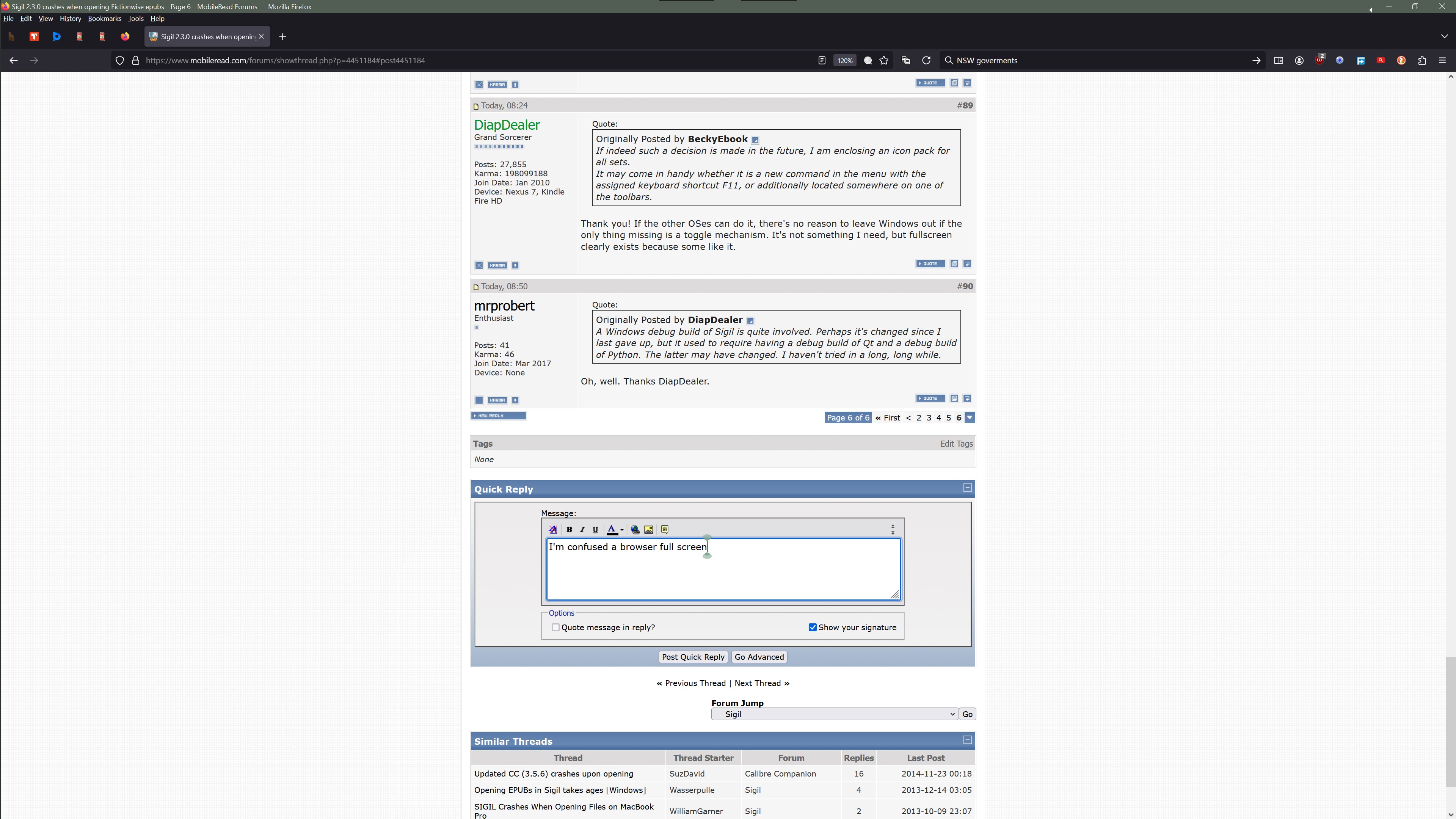

Question Confused
This is my Firefox browser maximized - via Alt+Space, MaXimize
Name:	browser maximized.jpg
This is my Firefox browser full screen - via F11
No title bar, no menu bar, no URL bar, no tab bar, no add-on bar etc - just the viewing area, I only use it when viewing a video.
Why would anyone want the equivalent in Sigil, i.e. no title bar, menu, toolbars, etc. Even I don't do everything with keyboard shortcuts… too many to remember

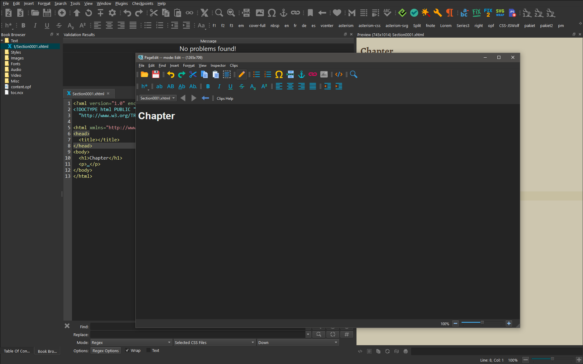

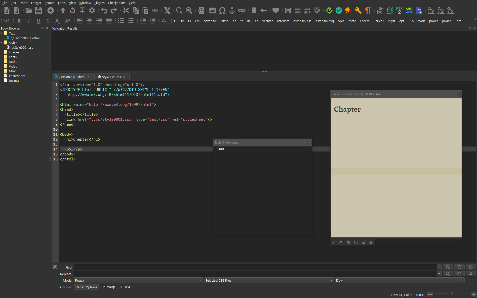

I never use FullScreen or Maximize.
But I have always wondered if you are in FullScreen mode, what happens when you use the PageEdit External XEditor button, or "Open With" or click on a link to show something in your Browser, or even new main windows created in Python plugins? What happens with floating QDockWidgets?
How would you even see the new Sigil main window created in macOS when opening a new epub using the File menu?
These are all tools I am constantly using and would hate to not have immediate access to.
I thought Full Screen mode existed only for Kiosk friendly apps.
Old 09-05-2024, 10:18 AM   #100
BeckyEbook
BeckyEbook's Avatar
Posts: 993
Karma: 3600000
Join Date: Jan 2017
Location: Poland
I believe it is not so bad. If I used a second monitor I think I could have Sigil on it full screen all day.
All the windows and programs you mentioned work normally. Widgets just are and work the same, also windows from plugins or external editors like PageEdit.
P.S. My default Sigil window mode is Maximized, but that may just be habit, Windows and the fact that I like to just switch between other also maximized windows.
