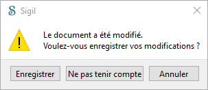

Okay, you found it, sorry for not being as clear as I thought.
About "switching to Qt theme":
In version 2.1.0 (and earlier), Sigil used Windows 10's native rendering system, which gave the UI a very square and flate appearance, since 2.2.0 Sigil use the Qt's integrated rendering system that was round and with relief. Image for exemple.
It was unspecified in the changelog and surprising, but unimportant.
So, the appearance of almost every element has changed (Tab, Text field, checkbox...) in some subtle way. I didn't notice the shrinking bug until just now, and given the significant change in the "switching to Qt theme" occured on 2.2.0, I assumed that this was the cause and that I hadn't noticed the problem until later.
And after testing, no, my bad again. The shrinking bug is specific to 2.3.0

For the record: Sigil never used Windows native rendering system. It was always a Qt style. That style changed to Qt's Fusion in Sigil 2.2.0 in order to accommodate On the fly dark/light theme switching.
