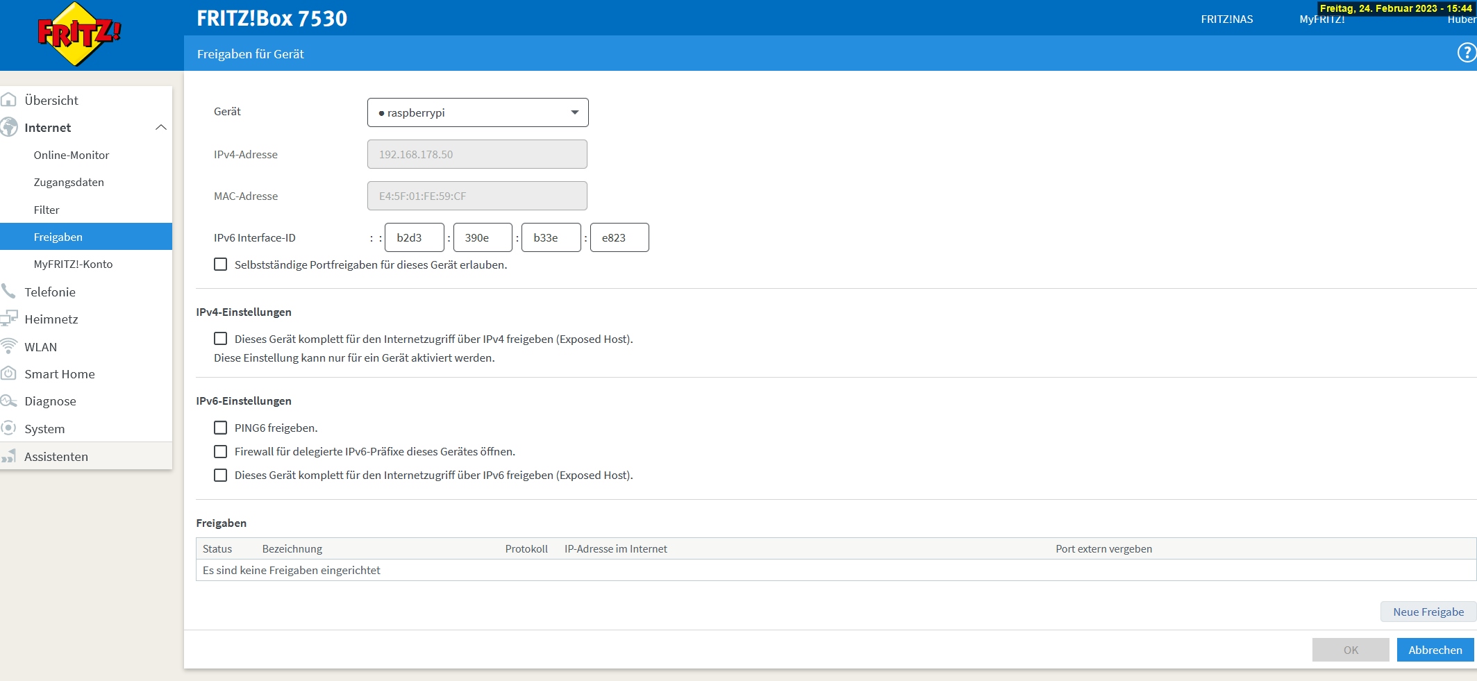

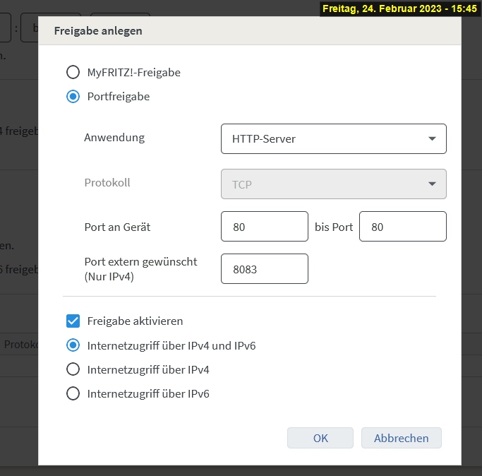

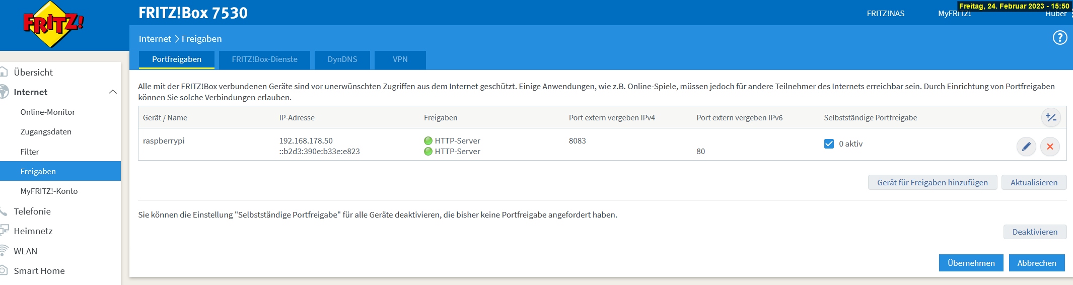

thanks for the link, that's what I already read/view at the net and I did it now. 3 pics are attached to give you an impression what I did till now.
I'm very sorry to bother you with my probs - I never thought that this will stress me so much

I would say it needs to be the other way round (80 extern and 8083 intern) but just test it.
No need for IPv6. just use IPv4 only.

well, you'll right - had to change it and now it works - I never thought that this drama would come to an end...
