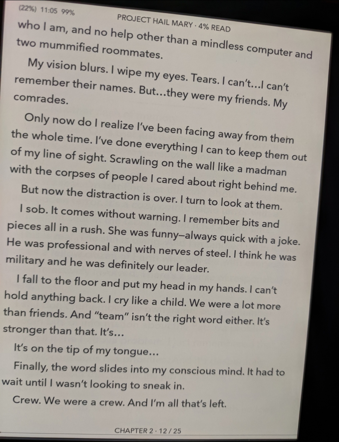

It is really weird. I can choose avenir next and sideloaded fonts no problem and with the patch every font has the advanced options and i can adjust the weight.
But problematic on reboots on my end and fine on other members here.
You can choose that, but instead of Avenir Next (sans serif font), the Georgia font will be displayed.
And everything written was tested for epub books.
Nope. Avenir Next is displayed. And Georgia displays fine as well.
Edit: ah for epubs. I am using kepubs. Will test on epub tomorrow
