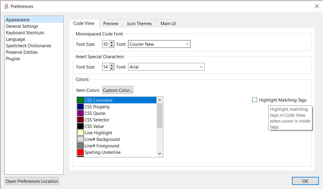

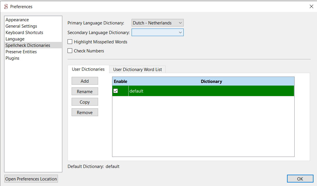

It is definitely the spell checking, when I turn of the option to highlight misspelled words, everything seems on par with 1.3.0.
The searches are quick, the right-click copy issue goes away and the occasional lag on the menus is gone.
The highlight matching tags does not have any noticeable influence.
What stumps me is why this does not happen on 1.3.0. with the spell checking on.
I have made some shots of my settings. As far as I can tell I am using the default temp location.

I just noticed from your Settings in your photo - your Primary dictionary is the Dutch - Netherlands, yet the book you are testing (sherlock holmes) with is set use "en-US".
Have you tried running your tests with your Primary dictionary set to English - US and Secondary Dictionary empty?
