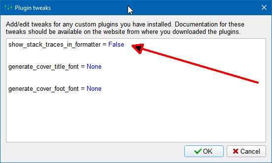

Originally Posted by un_pogaz View Post
Oh, I'm interested, I had used the template dialog and it took me a while to stop panicking about all the exceptions I had introduced in my code.
But how do I use it? I add "show_stack_traces_in_formatter = False" in any tweark configuration or I edit directly "tweaks.json" ?
Use the "Plugin tweaks" section. It is for tweaks that calibre doesn't know about, usually for plugins but also for "secret tweaks" like these. See the attached screen captures.
ID:	195107   Click image for larger version

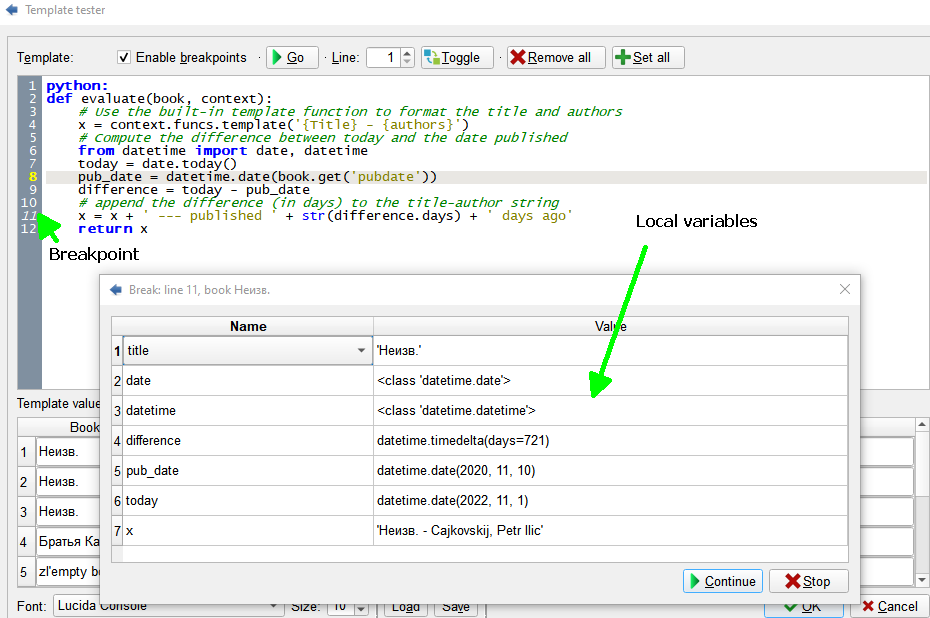

    If a function or template name name is also a Python keyword then append an underscore, as in 'template_()'
  • Breakpoints for Python templates in the Template tester dialog.

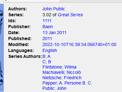

    Example: produce a list of books with a series matching "great" and output the books with the authors of all the books in the series:
    The command:
    calibredb list -f title,series,template -t templates/authors_for_series.txt \
                   -w 110 -s series:great --template_heading="Series Authors"
    The template (in a file). The template can be written in any of the template language modes. This one is in python mode:
    python:
    def evaluate(book, context):
        if book.series is None:
            return ''
        db = context.db.new_api
        ans = set()
        # Get the list of books in the series
        series = book.series
        if series in context.globals:
            return context.globals[series]
        ids = db.search(f'series:"={series}"', '')
        if ids:
            # Get all the author_sort values for the books in the series
            author_sorts = (v for v in db.all_field_for('author_sort', ids).values())
            # Add the names to the result set, removing duplicates
            for aus in author_sorts:
                ans.update(v.strip() for v in aus.split('&'))
        # Make a sorted comma-separated string from the result set
        res = ' & '.join(v for v in sorted(ans))
        context.globals[series] = res
        return res
    The output:
    id   title                      series       Series Authors
    1297 My: Books                  Great Series B, A & C, B & Flintstone, Wilma & Machiavelli, Niccolò &
                                                 Nietzsche, Friedrich & Papper, A. Persone B. C. & Public, John
    1300 Foo & Bar                  Great Series B, A & C, B & Flintstone, Wilma & Machiavelli, Niccolò &
    1313 Ünknown2 (foo)             Great Series B, A & C, B & Flintstone, Wilma & Machiavelli, Niccolò &
    1338 Udknown3                   Great Series B, A & C, B & Flintstone, Wilma & Machiavelli, Niccolò &
    1339 Put the Lime in the        Great Series B, A & C, B & Flintstone, Wilma & Machiavelli, Niccolò &
         Coconut                                 Nietzsche, Friedrich & Papper, A. Persone B. C. & Public, John
    1354 The Birth of Tragedy       Great Series B, A & C, B & Flintstone, Wilma & Machiavelli, Niccolò &
