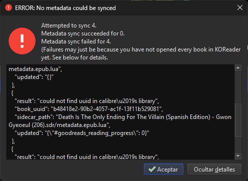

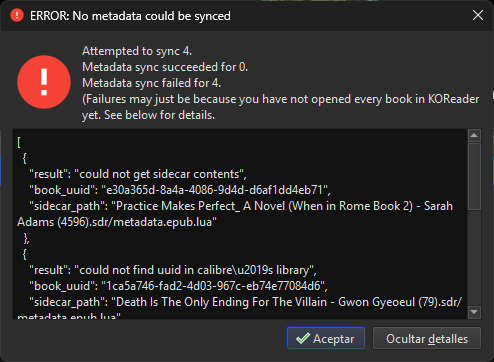

i'm having this problem
Name:	Captura de pantalla 2024-03-04 200821.png
ID:	206710   Click image for larger version
Name:	Captura de pantalla 2024-03-04 200835.png
ID:	206711   Click image for larger version
Name:	Captura de pantalla 2024-03-04 200845.png
Same. Trying to pull from a Kindle pw5

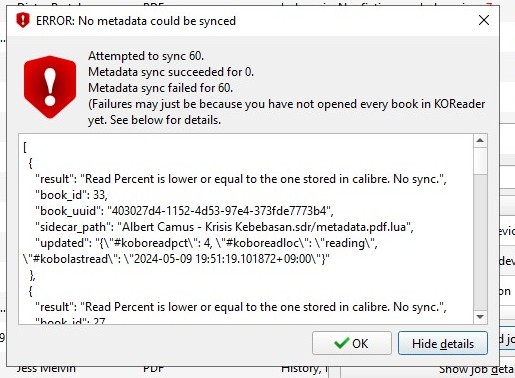

List of book Display
Hi, thank you for the KOReader sync plugin. I use it frequently to update my reading list.
One thing that makes things a little difficult is that when one or two books successfully sync, with Windows available, it's quite difficult to find which book files are synced. Is it possible to create a successful book list sync?
Thank you in advance.
