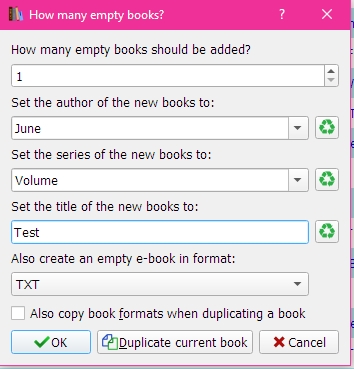

File "create.py", line 45, in create_book TypeError: a bytes-like object is required
See the attached images of a Calibre 4.99.3 bytes/string type error.

Old 01-07-2020, 11:54 AM   #99
eschwartz
Ex-Helpdesk Junkie
eschwartz's Avatar
Posts: 19,421
Karma: 85400180
Join Date: Nov 2012

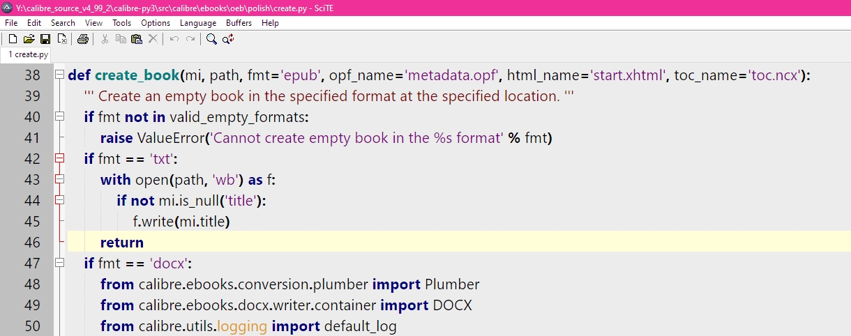

The module has a test which you can run like this:
$ calibre-debug /home/eschwartz/git/calibre/src/calibre/ebooks/oeb/polish/create.py /tmp/foo.txt
  File "/usr/local/calibre-3/bin/calibre-debug", line 20, in <module>
    sys.exit(main())
  File "/home/eschwartz/git/calibre/src/calibre/debug.py", line 349, in main
    run_script(args[1], args[2:])
  File "/home/eschwartz/git/calibre/src/calibre/debug.py", line 261, in run_script
    exec_path(ef, g)
  File "/home/eschwartz/git/calibre/src/polyglot/builtins.py", line 103, in exec_path
    exec(code, ctx)
  File "/home/eschwartz/git/calibre/src/calibre/ebooks/oeb/polish/create.py", line 126, in <module>
    create_book(mi, path, fmt=ext)
  File "/home/eschwartz/git/calibre/src/calibre/ebooks/oeb/polish/create.py", line 45, in create_book
    f.write(mi.title)
TypeError: a bytes-like object is required, not 'str'
https://github.com/kovidgoyal/calibre/pull/1085

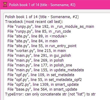

Polishing Job: TypeError
TypeError: can only concatenate str (not "list") to str
See the attached image.
DaltonST

Old 01-07-2020, 11:19 PM   #102
Posts: 45,716
Karma: 28549306
@DaltonST: that TypeError is not python 3 related as fr as I can see. And the font subsetting error has been fixed by https://github.com/kovidgoyal/calibr...ed799a8d110ae2

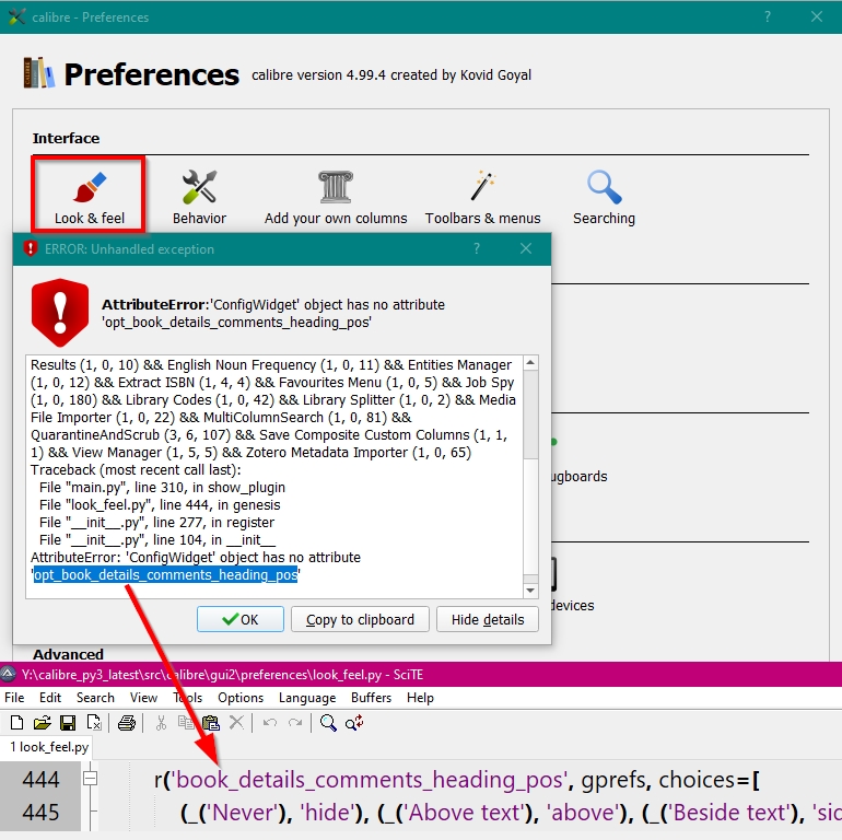

V4.99.4 look_feel.py Error in Preferences > Look & Feel
DaltonST
