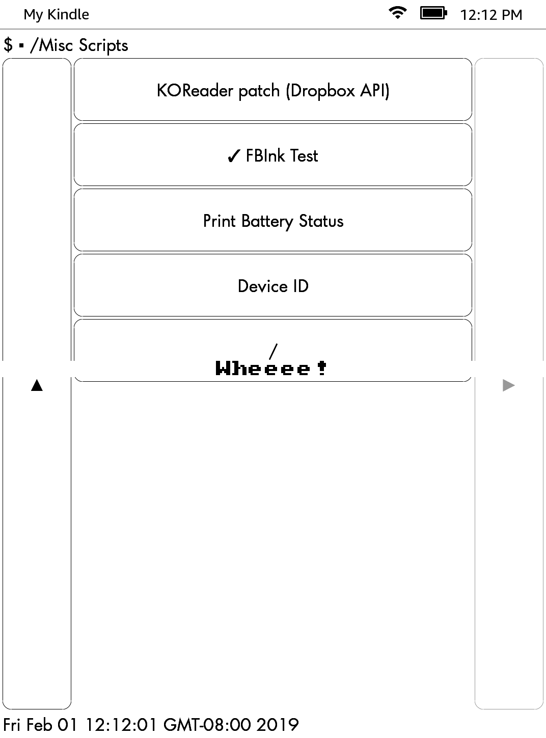

If you could provide me with a screenshot and the terminal output from something like
fbink -Mmp 'Wheeee!'
that'd be helpful .

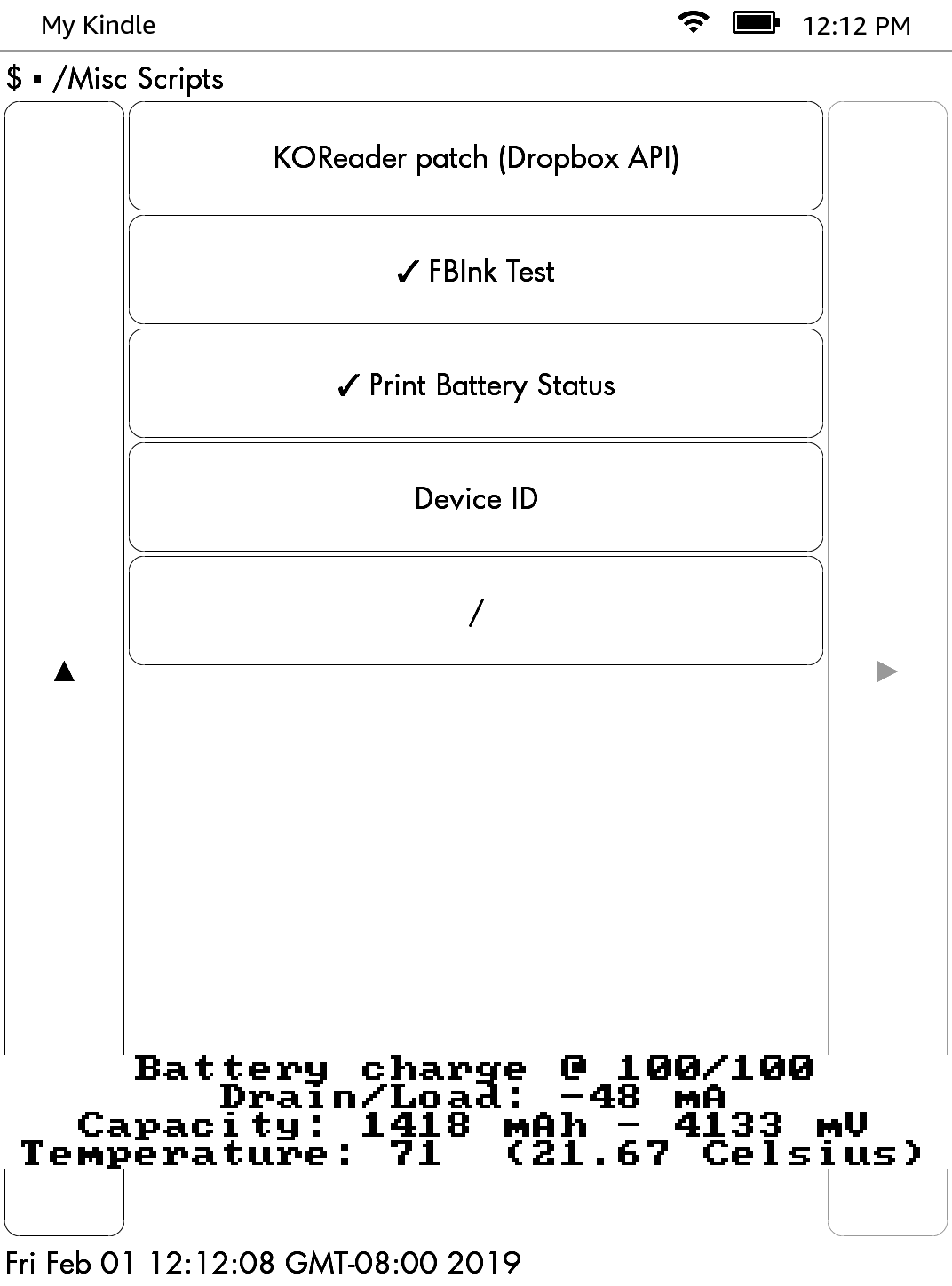

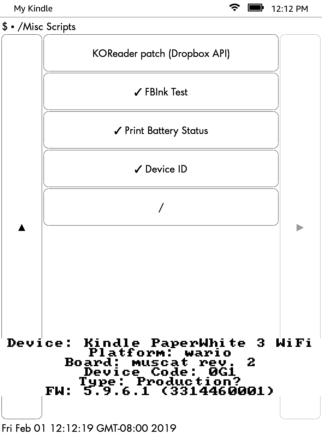

that'd be helpful .
Sorry it took so long. It just flashed quickly and went away when I used kterm and it seems like I couldn't take screenshots in kterm anyway. I had to figure out how to do it via KUAL (ended up piggybacking on battery-status.sh). Needed to figure out how to redirect stdout/stderr to a log file, too.
This one's on a PW3.
[FBInk] Clock tick frequency appears to be 100 Hz
[FBInk] Screen density set to 300 dpi
[FBInk] Variable fb info: 1072x1448, 8bpp @ rotation: 3 (Counter Clockwise, 270°)
[FBInk] Fontsize set to 32x32 (IBM base glyph size: 8x8)
[FBInk] Line length: 33 cols, Page size: 45 rows
[FBInk] Vertical fit isn't perfect, shifting rows down by 4 pixels
[FBInk] Fixed fb info: ID is "mxc_epdc_fb", length of fb mem: 6782976 bytes & line length: 1088 bytes
[FBInk] Pen colors set to #000000 for the foreground and #FFFFFF for the background
Printing string 'Wheeee!' @ column 0 + 0px, row 0 + 0px (overlay: N, no BG: N, no FG: N, inverted: N, flashing: N, centered: Y, halfway: Y, left padded: Y, right padded: N, clear screen: N, skip refresh: N, font: 0, font scaling: x0)
ID:	169437   Click image for larger version
