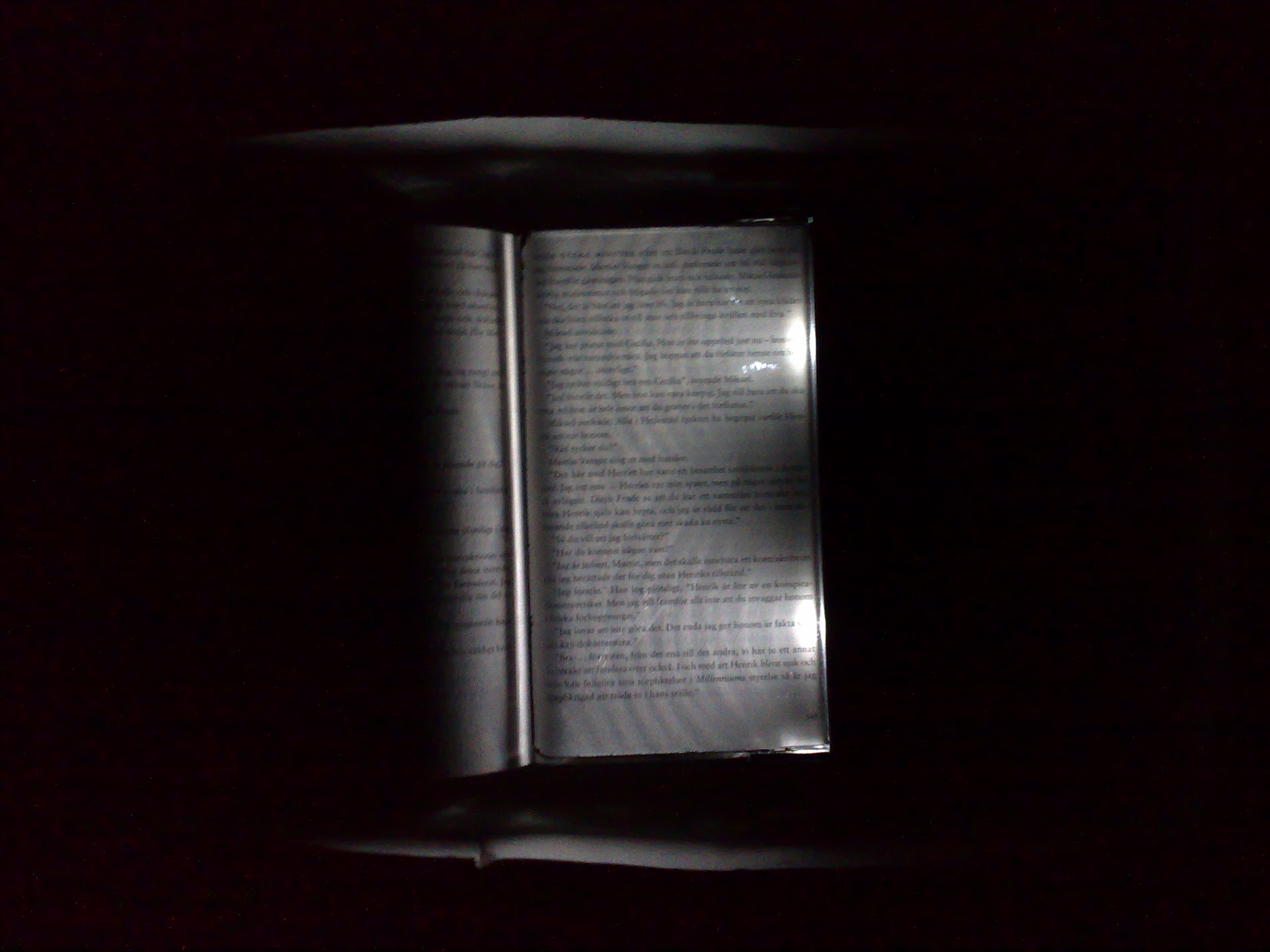

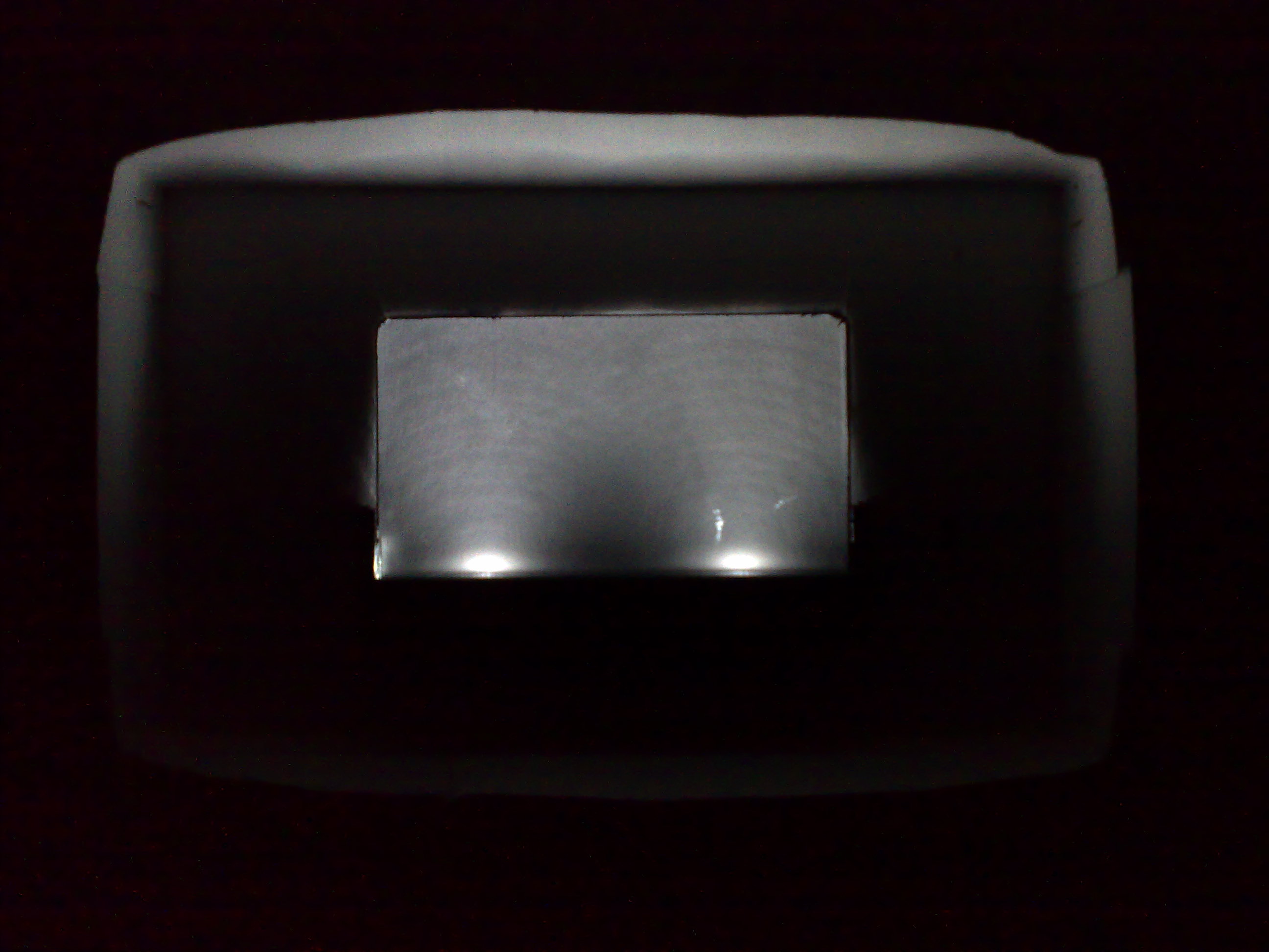

Okay,pictures of the light wedge with three sides painted, the long side and one of the short sides has a lip of paint mybe 1mm onto the flat surface (the color on the edge is a shallow U shape looking at a cross section)
The color si sticking very well so far, tried rubbing it and it doesn't rub off. I cn scratch some off if i use a metal spoon, but all in alll I think it'll stay put nicely.
I *think* the light might be a little more uniform, but it might just be my imagintion. Besides the light wdge I have has quite uneven light fanning out from the two lmps, so it's hard to tell if there is a difference... I wish I'd remembered to take before and after pictures with a book in same circumstances.

June, thanks for posting those pictures.
I will attempt exactly the same thing with the Sony lightwedge.
Looking at the pictures I tend to agree. As you described, the "masking" you did appears not to have a significant effect on how the light is distributed over the reading surface. Since your wedge has only 2 but apparently very bright LEDs the light cones are more prnounced compared to the Sony PRSA-CL1 with its 4 LEDs. The problem the Sony wedge has (besides the light leakage) are not the light cones but these typical vertical artifacts which were described as smudges earlier in the thread. My hope is that these might get better as a welcome side-effect with the proper masking technique.
Anyway, I am glad that you seem to be happy with your modification.

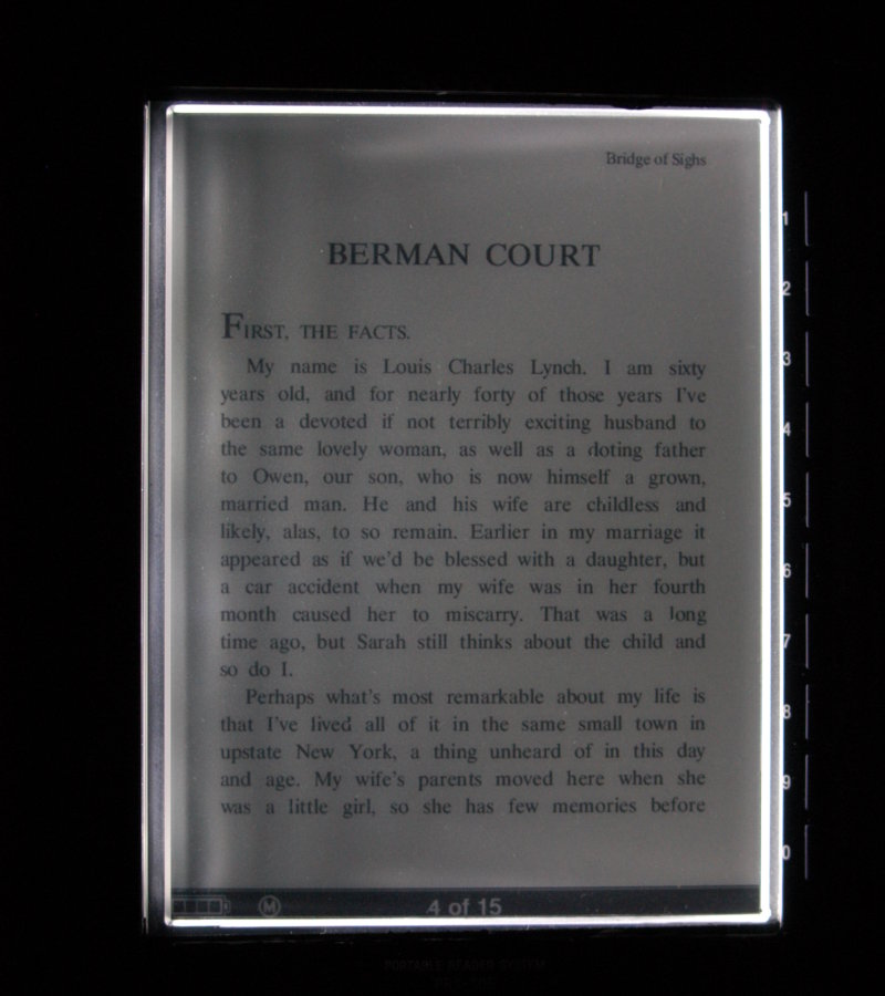

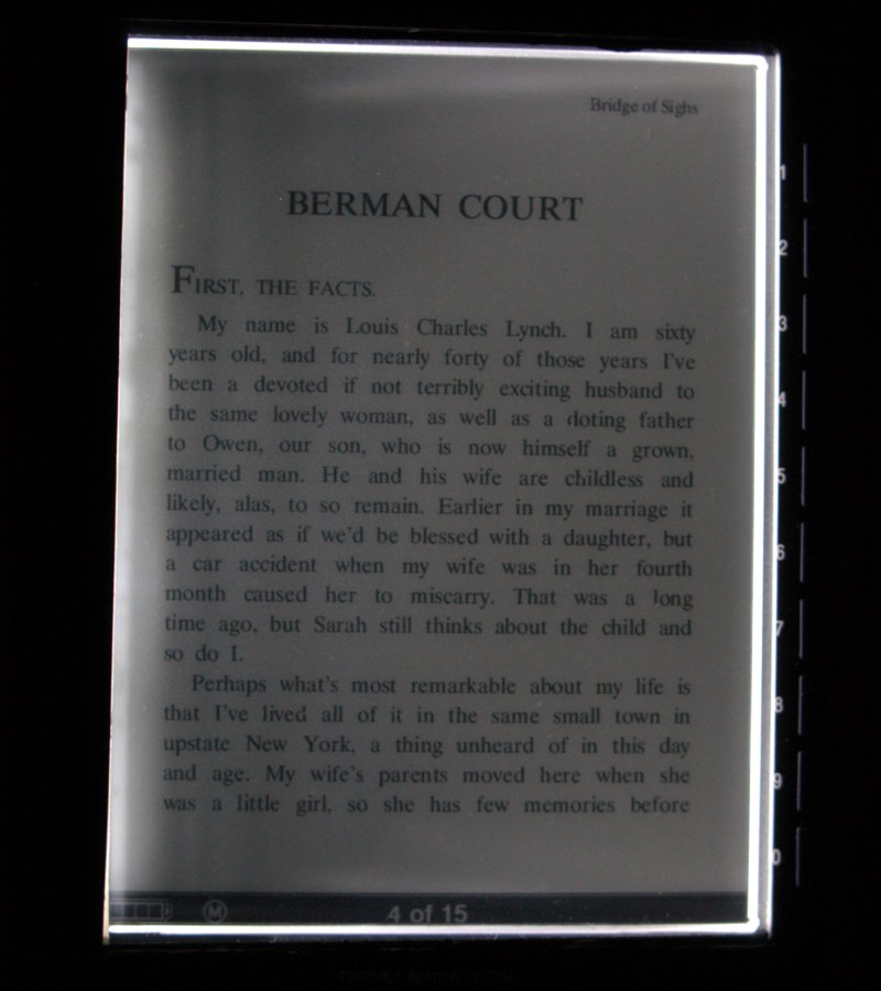

To determine the "masking effect" with the Sony PRSA-CL1, I did one further experiment. Since this time it did not involve any paint brush it was not that hard for me.
Quick recap: The current status is that I have blackened the shorter triangular edges of the wedge with ceramic paint to block some of the excessive light. The two longer edges are yet untouched. The typical smudges or shading patterns are still visible, if not increased a bit.
The current experiment involved two strips of plastic duct tape. One strip is white. I glued that one along the long edge on the left side so that the bright outline on that edge is just covered and the reading area is still fully visible. Since the white tape was not entirely opaque I glued a strip of black tape right on top of it. I now have a black tape with a white bottom that faces the e-ink display. The idea is that the white tape reflects some of the light back on to the reader and by doing that lessen the smudges.
Look at the pictures and see the effect. I found it quite interesting. The first picture (DSC_0865_800.jpg) is without the tape. The second picture (DSC_0863_800.jpg) is with tape applied.
Sorry for the size and brightness differences in the pictures. I just moved and misplaced my tripod. But the effect comes out pretty realistically.
