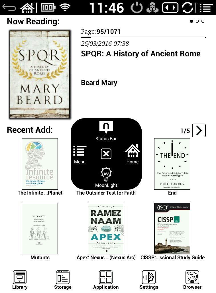

I noticed that if I long press the back button, a virtual d-pad pops up, but none of the buttons work. Is there somewhere that it can be configured?

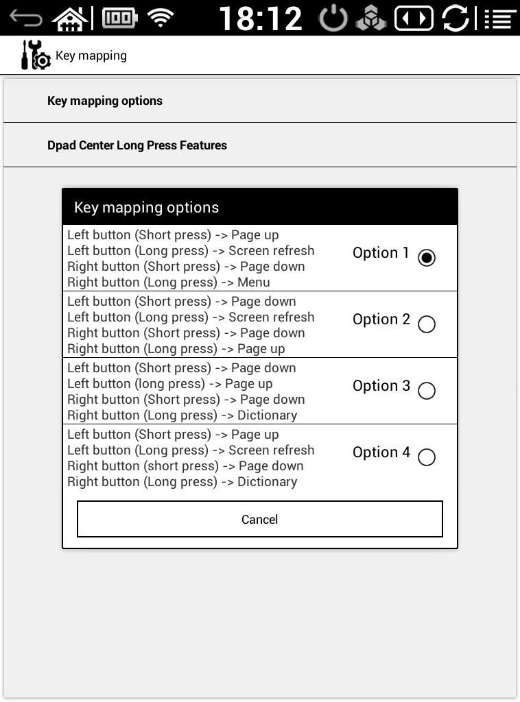

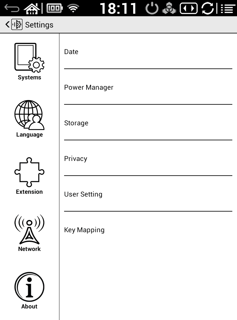

The settings configured in the Content Browser. Choose, as shown in the picture
ID:	147404Click image for larger version
Thank you, I guess I was not specific enough.That is for the hardware buttons, which work fine. See attached for pic of virtual D-Pad. It is the black square in the middle of the screen. It appears if I long press my back button and would be very handy if I could get it to work, but currently none of the selections on it are clickable.
mising is offline   Reply With Quote
Do as I said above...
FOV is offline   Reply With Quote
This popup menu is a relict from the onyx firmware and is not working and was never working. Sorry.
