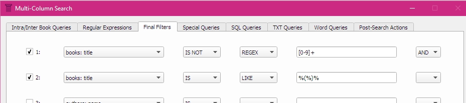

Version 1.0.63 - New for Final Filters: Added a new operator, "REGEX"
Originally Posted by Vortex View Post
That works OK except for it also finds books with the series name in the title not in brackets, but where something else in the title is in brackets, like:
Author: Joe Bloggs
Title: The Series Name: The Book Title (Book4)
Series: The Series Name
Anyway, I can work with that.
Thanks.
@Vortex:
I just uploaded a new version of MCS:
Version 1.0.63 - 02 June 2016 Final Filters: Added a new operator, "REGEX"
This new Final Filters operator should allow you to narrow down your Special Queries search results. The more Filters you specify, the more refined will be your search.
See the attached image.

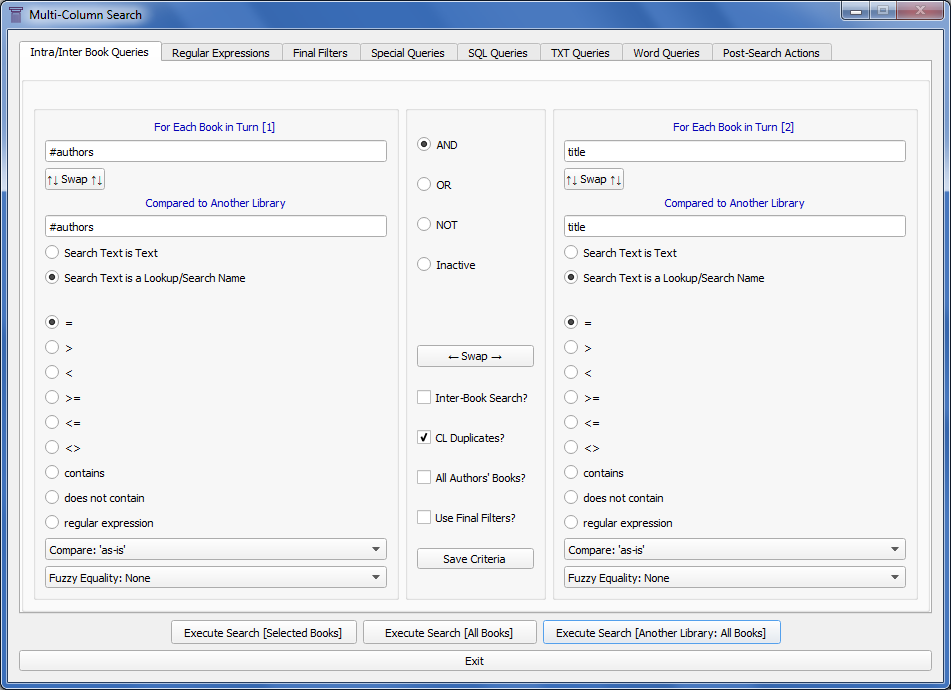

Attached is a .zip copy of MCS with the new Cross-Library Search for Duplicates Using Custom Columns (and/or Standard Columns).
Could you please test this before I release it officially?
There is a new checkbox in the middle, "CL Duplicates?". CL = Cross Library.
Note that you can compare only 2 different Custom Columns simultaneously, so the top and the bottom Custom Columns on the left must be identical, as do the ones on the right.
You can compare 1 Standard Column and 1 Custom Column simultaneously too.
Also, 2 Standard Columns.
Note that you see not only what is a duplicate in the current library, but also what is a duplicate in the other library. Be sure not to miss the independent window showing Cross-Library Search Results, be they from CL Duplicate Searches or the previously available CL Intra-Book Searches.
That CL Search Results pop-up window can be missed if you happen to click another window just as it is being shown. It will remain active, but you might not notice it until later.
I have a lot of automatic edits in place that watch what you do while setting the Search Criteria, and either fix it for you or give an error message, analogous to what the action of checking the Inter-Book Search box does.
Let me know how it goes.
DaltonST

Maybe it's me who doesn't understand how it's supposed to work.
But I've attached a screenshot of the settings that I thought would work, but it doesn't find anything, although I know that there should be 3 duplicates.
I've tried with my custom column named "Authors" and the standard titles from Calibre.

Did you get the gui log results window at all? If not, did you select the other library's metadata.db after clicking the execute button? Is there a network drive involved?
Do a normal CL Intra-Book Search to ensure that works for you. If it does not, then try it on another library that is on the same pc local drive.
Regardless, I will post a revised beta version in the same place as before later today after I do more testing and tweaking. Thanks.

I get the log window, but it doesn't show anything.
If I "turn it around" and then use Library B as basis and search for duplicates in library A it does find them.
also with custom columns.
I'll try and test some more.
Also:
Everytime I choose "CL Duplicate" I can't choose the "contains" option it's always = option.

Only = for CL Duplicates just like for Inter-Book Searches. Contains is used with Intra-Book Searches, whether CL or same library.

I guess that means that the column has to be an exact match across different libraries?

Yes. Duplicates. Otherwise, the CL search is just a normal CL search instead of a CL Duplicates search.
