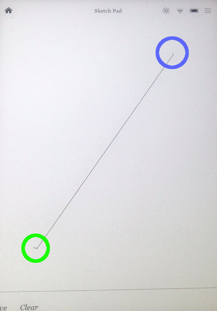

I don't have this problem. The closest I got in trying to reproduce is this:
If you touch the display as the reader is going to sleep. Only after it is asleep (give it a few more secs, it's still awake for a short while) let go the display. And then wake it up using the power button. Then the first time you touch the display it does not register.
Or rather, it does register, but as a swipe motion, it becomes visible in Sketchpad. I touched it in the lower left corner before sleep. Then tapped the upper right corner after wake up. And Sketchpad draws a straight line between those two points.
From the software point of view, the touchscreen is kind of like a keyboard. Touching the screen is like pressing a key. Letting go of the screen happens while the device is asleep and thus does not register. So on wakeup the software still believes it's being pressed. When you touch it again, it does not register you pressing the key, it just registers the new coordinates, and you letting go of the key. Thus you get this giant swipe in a perfect line.
None of that should stop the screen from working altogether, though.

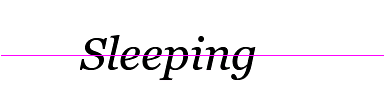

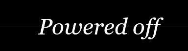

Location: Heidelberg, Germany
For some reason nickel executes dd before going to sleep (or power off). So an alternative method would be to hook into dd, and then look at the display. This is easy if you restrict yourself to a single line of pixels. So you can make a single line pattern that matches the Sleeping and Poweroff screens respectively. It would be an alternative approach to screensaver for devices that don't work with the current method, and in case the log message method breaks entirely in the future (it seems the message I originally used is not coming back).
Problems with this approach, however, are several:
- needs a different pattern for each device/resolution/language, so there must be a (simple?) way for users to come up with these patterns by themselves
- timing. at the time dd is called it's not yet showing the sleeping/poweroff screen. That appears 0.x seconds afterwards. Then you only have a short time until the device is actually asleep or off and the magic has to happen in between
timing already is an issue with the current incarnation of the script.
On the upside this approach might make it possible to have different images for sleeping and poweroff states.
