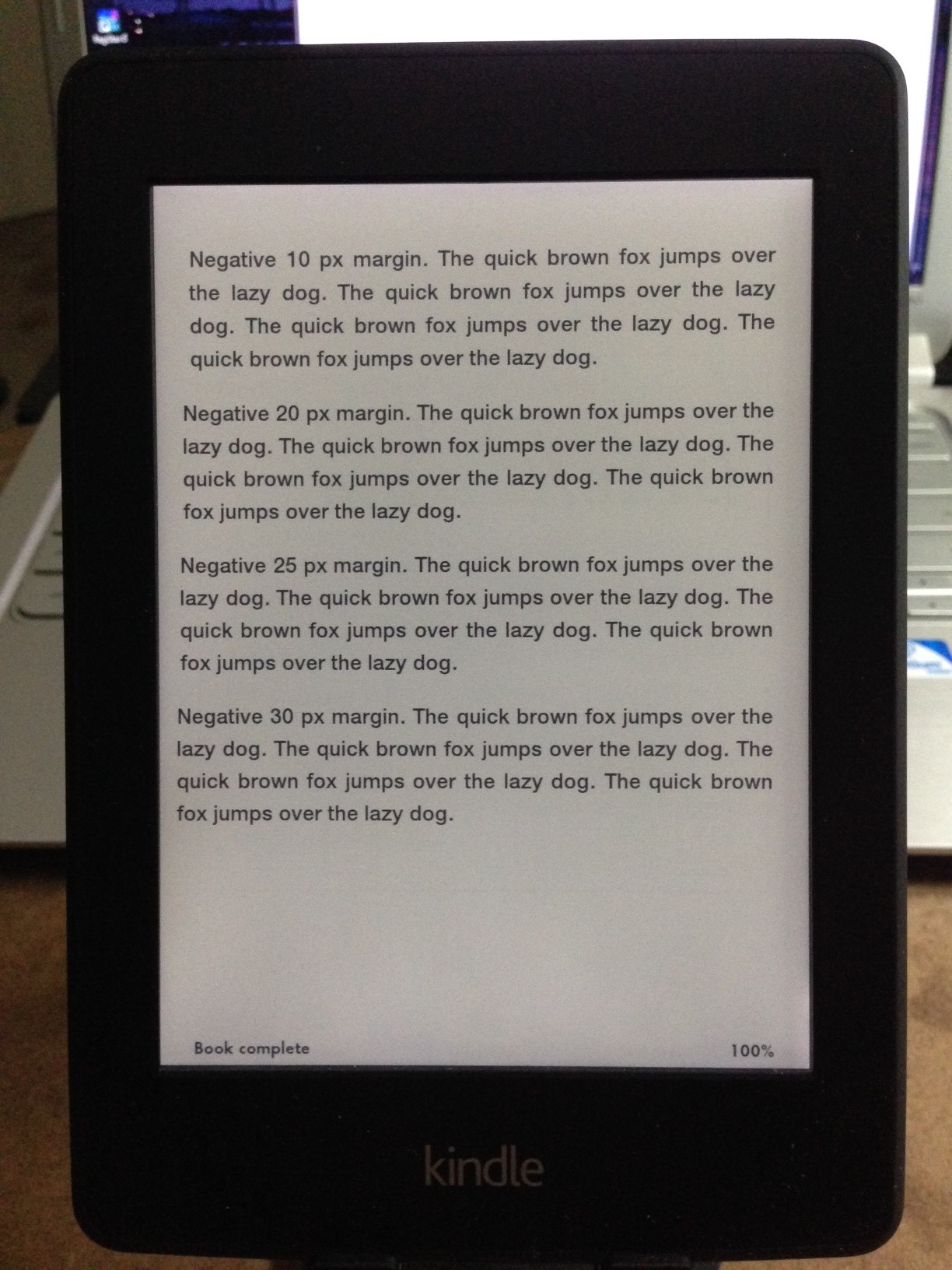

Negative margins do work. Here is a sample doc I whipped up in a hurry. It contains negative left margins of different sizes. In my hurry I forgot to include negative right margins. I placed the margin-left CSS in the paragraph tags because it didn't seem to work correctly placing it in the body tag.

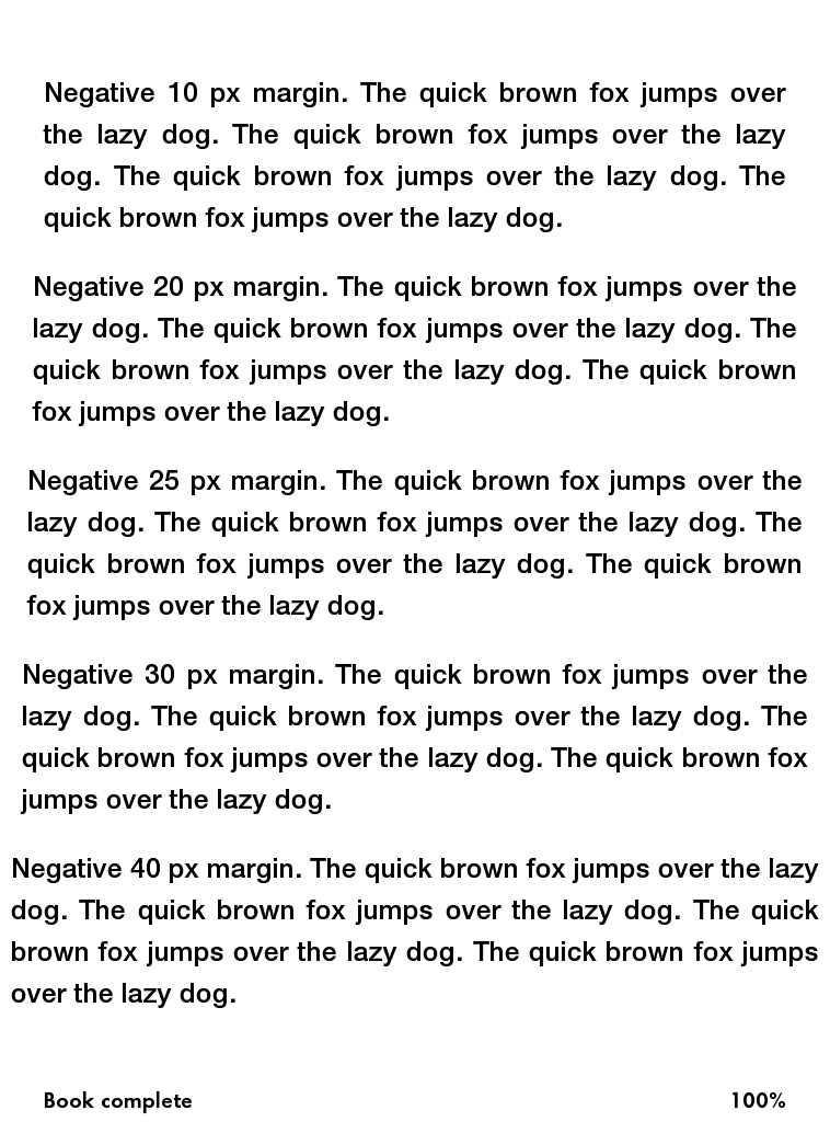

Same doc as above but with both negative left and right margins.
Very nice. That is one thing that has bugged me about the Kindle is the forced margins. Getting rid of them so easily is very good.

Unfortunately the following CSS wouldn't work:
body { left-margin:-40px; right-margin:-40px; }
Or a class placed inside BODY tag:
.bodyMargins { left-margin:-40px; right-margin:-40px; }
Or this:
* { left-margin:-40px; right-margin:-40px; }
This works fine. I haven't tried DIV tags
p { left-margin:-40px; right-margin:-40px; }
It would have been so much easier if it worked from inside the BODY tag.

A left & right margin of -30px works very well for a Kindle Touch.
As you can see from the screen capture I attached a few posts ago, even down to -40 looks okay on the PW2. I think much beyond that and the text will be too close to the side of the screen. This is a nice trick, but it is still a PITA that we have to manually insert it for books rather than having a built in margin feature on the Kindles.
