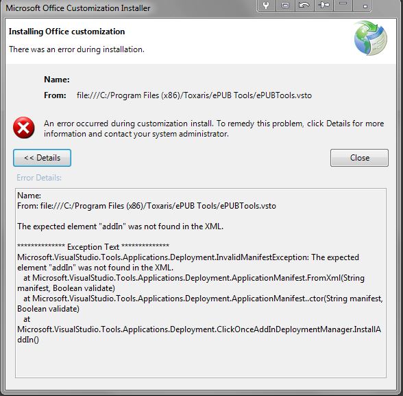

Install Fail
Hi Toxaris
Installed EPUB Tools, when I started Word 2007 I got an error, see attachment for details
In case its relevant - I have VS 2008 installed on this box

Hi Toxaris
The add-in is created with VS2010. Therefore it requires the VSTO2010 runtime (as specified). It can not operate with VSTO v3, which is delivered by VS2008 unfortunatly. That is causing this error.
If you would install the VSTO2010 runtime, it should work fine. As far as I know, installing the runtime will not cause a conflict with VS2008.
