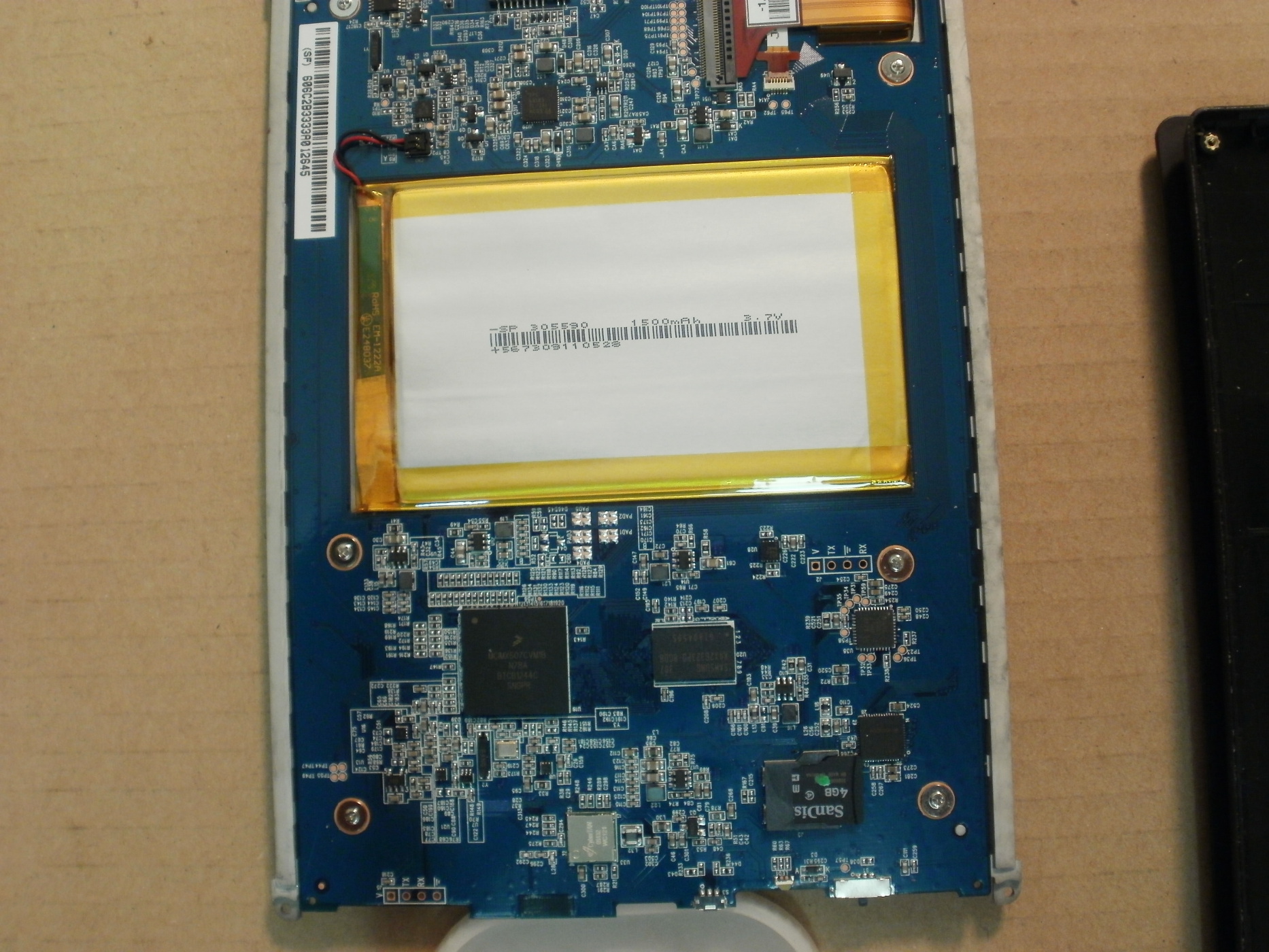

Ah.... It is COMPLETELY DISCONNECTED!!! But how do I connect it back??? Oh, I need a picture of how it should be...
UPDATE: and it is just IMPOSSIBLE that I disconnected it myself. I didn't even touch it. It must have been ALMOST disconnected before....
I only touched the uSD card, nothing else.

Old 08-24-2013, 02:20 PM   #95
Ken Maltby
Ken Maltby's Avatar
Posts: 4,466
Karma: 6900052
Join Date: Dec 2009
Location: The Heart of Texas
Ok; I'll attach a picture on edit.
https://www.mobileread.com/forums/att...1&d=1367528183
If you look at it full size, the brown part of the connector can be flipped up to release/insert the film and pressed back down to secure it.
Luck;
Ken
Ken Maltby is offline

Here is how it is at the moment:
http://www.bibles.org.uk/Kobo.jpg
tigran is offline

Ok, I got light now!!! Thank you.
Now only the top right corner is a problem...
