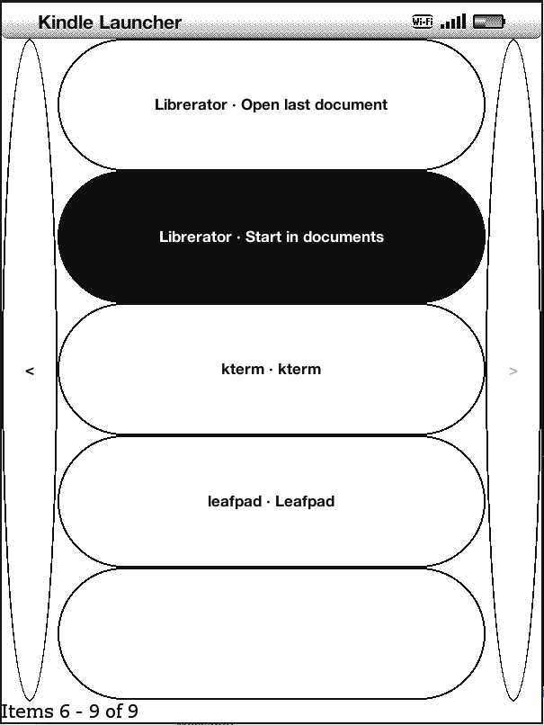

Any similar Kual support on the offing there Kai?
cheers
Sure, why not? Added to the first post.

Super hero. Will update the docs to reflect the support. Much appreciated.

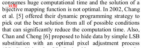

I use Kindle DX graphite running Librerator-R2 to read the attached file with 2-column mode (press “F”), when go to the last paragraph on page 1, the Kindle DX screen become frozen and it is unresponsive, even press the power switch.
Please tell me how to recover, thanks.

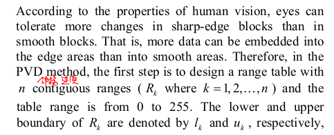

Originally Posted by heriberaht View Post
... when go to the last paragraph on page 1, the Kindle DX screen become frozen and it is unresponsive, even press the power switch.
As Kai said long press the power.
I did notice a couple of Chinese notation marks? in the text... pictured.
Perhaps it was these notes that caused the glitch?
Total guess
Honestly, you should take that doc down. Hope that helps.

Okay. I can confirm on a DX in two column mode (as specified) the first instance of the chinese note hangs the device. no.. it's not that. you can browse to it backwards. it's actually the pre-render of the second page that fails for some reason from the Forwards direction?
Put simply going from that page to the next one in a PAGE NEXT direction kills it.
not other pages nor directions, nor special markup characters, do this.
Just that one thing.
a killall -9 reader.lua is required to restore life.
I get the sense that this is such a corner case it may well be in the pre-fork code too. definitely gremlins. but done know what they are now???
IIRC there are two such notes in the doc. will try to "jump" to the second and see if that kills it. If so I think we can call that "conclusive" that the fault lies somewhere there.
<-- I did this. nothing to do with the characters far as I can see.
So far it could also be pre-rendering the next page (in my mind) that kills it. will test. <-- this I think now for sure. but why ? I don't know.
EDIT: Pdf-reflow works fine... oddness
