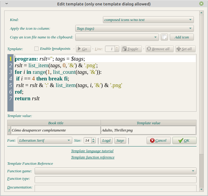

Hello everyone, I have an advanced rule that I use in the emblems part to show me the author's image next to the cover.
program: rslt=''; tags = $tags;
rslt = list_item(tags, 0, '&') & '.png';
for i in range(1, list_count(tags, '&')):
if i == 4 then break fi;
rslt = rslt & ':' & list_item(tags, i, '&') & '.png'
rof;
return rslt
I thought about using it in the tags column to put one icon per label but it only shows me a single icon with the images of the other tags.
Any solution or comment would be helpful.
rof;
return rslt
Tags use a comma as a separator, not an ampersand.
Thank Chaley, it worked!!

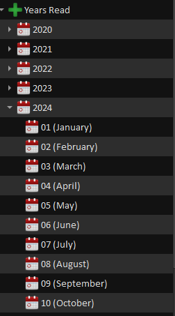

As I often re-read books, I like to store all my completion dates in a taglike column (e.g. 2021-03-13, 2022-04-21, 2023-04-17, 2024-05-29). I use this composite column to group them by month in the tag browser:
program:
	new_dates = '';
	for dates in '#datesread':
		converted = format_date(dates, 'yyyy.MM (MMMM)');
		new_dates = list_union(new_dates, converted, ',')
	rof
ownedbycats is online now   Reply With Quote

It looks really good. But I'm always afraid - justified or not - that all the composite coloumns will make calibre slower and slower.
Wiggo is offline   Reply With Quote
