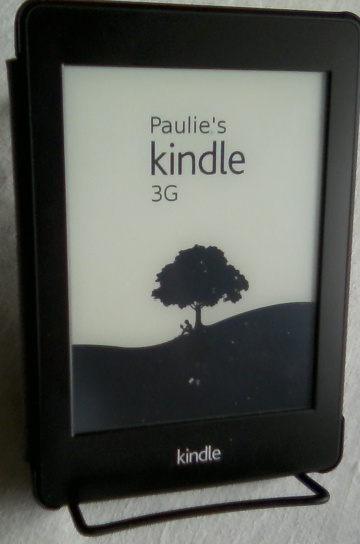

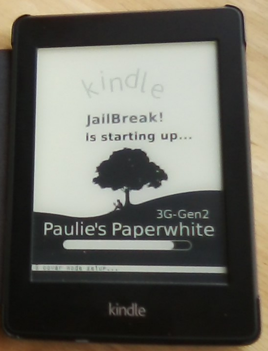

Here's my latest set of reboot screens. I also modified the ubiquitous "splash" screen... the plain boy-under-tree image which comes up between the other. This is the one that displays the progress circle which you can see has gone to about 7 o'clock in my shot.
For shutdown/reboot:
"/usr/share/blanket/shutdown/bg_medium_reboot.png"
For the in-between "boy-under-the-tree":
"/var/local/blanket/low_level_screens/images/splash.png"
For the startup:
"/usr/share/blanket/splash/bg_medium_defaultbg.png"
ID:	120284   Click image for larger version
ID:	120359   Click image for larger version
