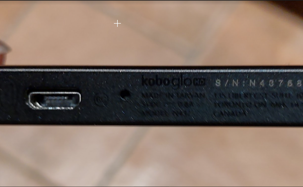

Strangely enough, I could not get the factory image to work. I've tried 2 different microSD cards, both 4Gb, and neither was accepted by the device. When I tried to boot with those cards, the red power light lit up briefly, then went out and the screen just stayed blank. I ended up triple-checking the model ereader that I was working with, but it is indeed a Glo HD.
