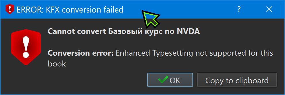

I convert the training material my company has written with Calibre and use the Kindle plugin to convert to KFX format for those who use Kindles. Normally it works fine, but I have a book which has been translated to Russian. It gets 67% of the way through converting fairly quickly, then sits there for 25 minutes (actually 27:26 apparently) before throwing an error: Conversion error: Enhanced typsetting not supported for this book.
Any ideas on how to fix this, please?
The Kindle Previewer sometimes fails to give a specific reason for conversion failure. That appears to be the case here. If you post the job log from the conversion it may be possible to determine something further from that.
See the section on "Dealing with Conversion Errors" in the first post of this thread for more information.
I have the same problem with the Vietnamese ebook. Kindle Previewer doesn't support this language books. I tried to change the Epub language to English. It worked.
Edit book -> Content.opf -> <dc:language>en</dc:language>
And you require set languages in metadata too.
Hope this help!
