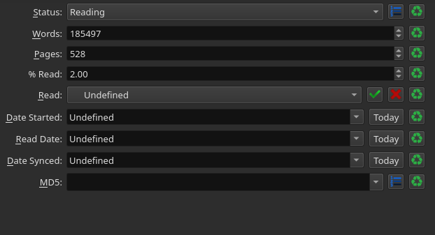

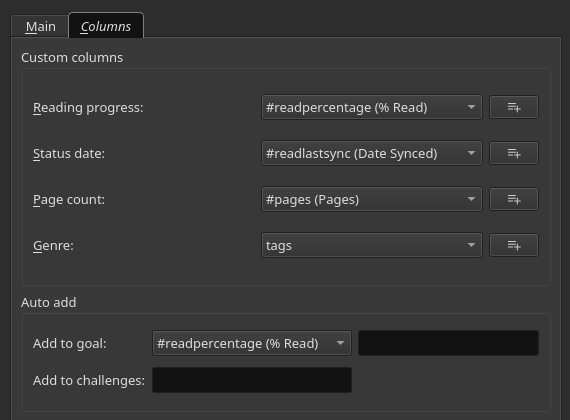

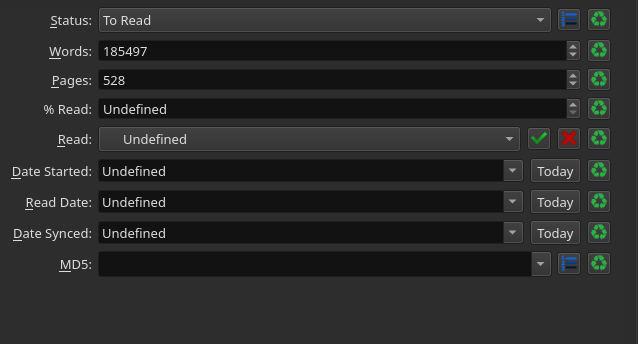

Here are the screenshots which worked in the previous version. No matter if I change from undefined to 2.00 and save, and then change it from 2.00 to 3.00 and save, the book is never added. It is added if I set it to 2.00, close calibre, manually set "auto_add_check" to True in the json config and start up calibre again.
Thanks so much for looking into this
ID:	217895   Click image for larger version
ID:	217896   Click image for larger version

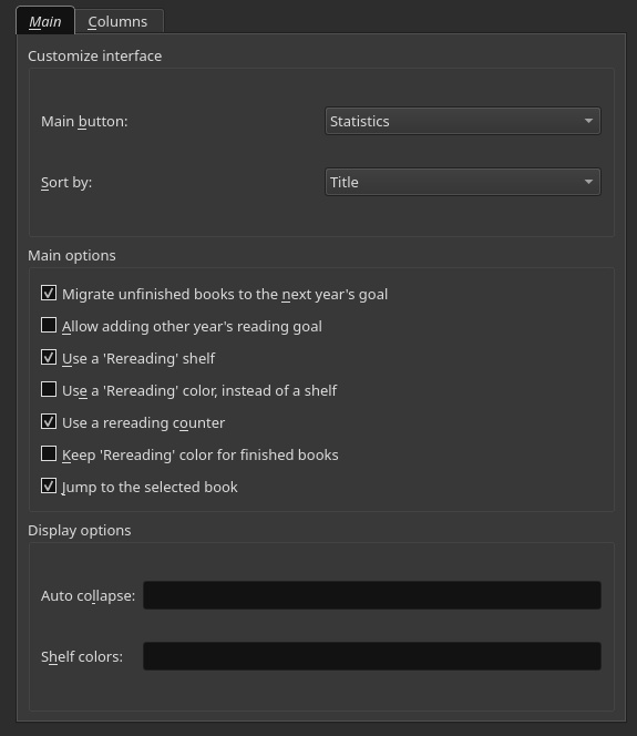

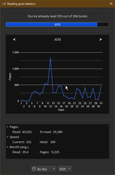

I have a fanfic that's been in progress and I've been reading for many years. It finally finished. Is there a way to add it to the Reading Goal without adding thousands of pages to a single day and completely messing up the daily graph?
It also happened last month:
Name:	2025-09-08 11_01_45-Reading goal statistics.png

Old 09-08-2025, 01:49 PM   #911
thiago.eec
Posts: 1,311
Karma: 1436993
Join Date: Dec 2016
Location: Goiânia - Brazil
Attachment 217988
I guess you couldn't update the reading progress before because the book wasn't finished, right? If so, I don't see how we can handle such cases.
I'm open to suggestions.
thiago.eec is offline   Reply With Quote
Old 09-08-2025, 02:04 PM   #912
ownedbycats
Custom User Title
ownedbycats's Avatar
Posts: 11,526
Karma: 81412473
Join Date: Oct 2018
Will it work if I set it to 98% and then 100%, just adding the chapter I read?
Old 09-08-2025, 02:47 PM   #913
thiago.eec
Posts: 1,311
Karma: 1436993
Join Date: Dec 2016
The day receiving the 98% would still be off. There is no current way to avoid that.
Old 09-08-2025, 05:34 PM   #914
ownedbycats
Custom User Title
Posts: 11,526
Karma: 81412473
Join Date: Oct 2018
And I guess even if I did insert the starting date, it'd still have a massive jump. Hmm.
There's three things I can think of:
1. Average out the pages between the records instead of putting all the pages in on the date of new record.
2. A way to exclude pages from certain books?
3. Maybe ignore books that only have one date?
