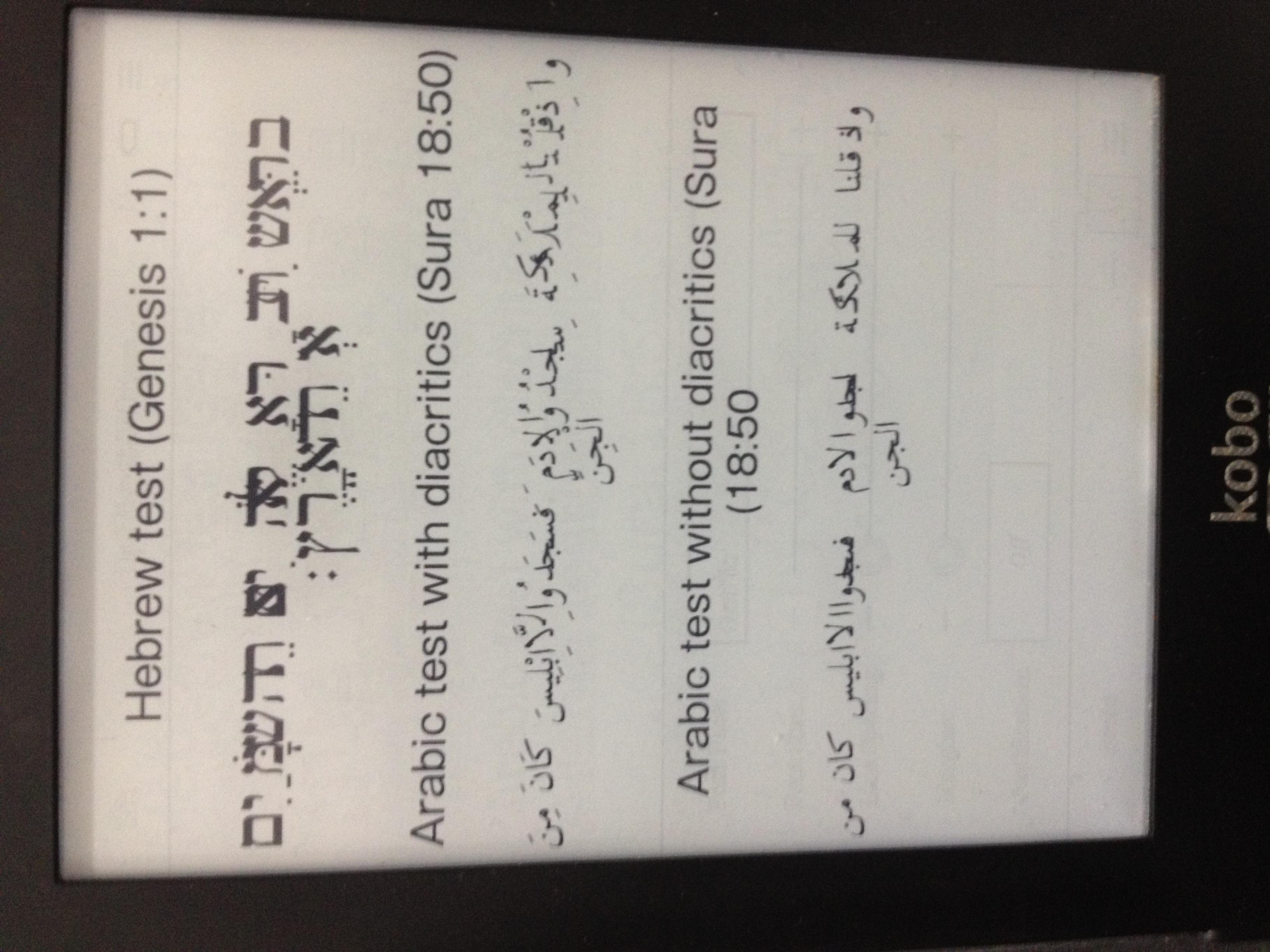

Could you please take a screen capture of my Hebrew/Arabic test file with and without publisher fonts enabled?
I put it on my Kobo Glo and took the attached photo. The font is set to Gothic and the largest that would get all the text on one page. If I set the font to "Document default", the only differences are in how the English text is displayed.
Thanks for testing this! The Kobo does indeed display the Hebrew and Arabic texts RTL, but there are major display issues both with Hebrew and Arabic. Many Hebrew and Arabic letters partially overlap and there are gaps between some of the Arabic letters.

The problem seems to be diacritics/ligatures. The couple of Hebrew samples I've seen (without diacritics) looked fine, using Ezra SIL as well.

In my Aura it looks exactly the same as davidfor's picture, except that the Hebrew diacritics don't overlap with the next line (maybe because I have applied the line-height patch). By reducing the font size, some things change, for instance, the first two letters (bet, resh) appear inverted (resh, bet), with a ~60% overlap between them.
