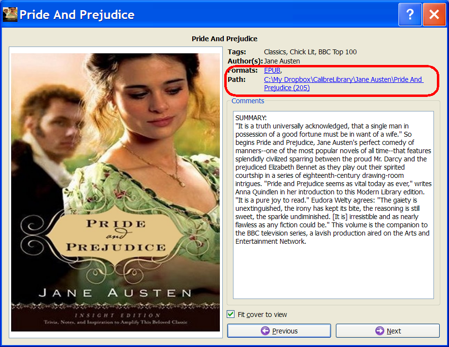

Originally Posted by itimpi View Post
I know that USED to be the case, but I am no longer seeing it since the latest change to the GUI design. I think that is because at one time the path was displayed, while now you get the "Click to Open" with the id displayed as part of the Tooltip. This makes the information a bit less obvious (which may of course be a good thing).
It's nice to know it is available in the tooltip. It is also available in the book info view, see attached.

The only difference, is you now "hover" over the format, to see the Title path info. (the numbers belong to the title, not the author)
