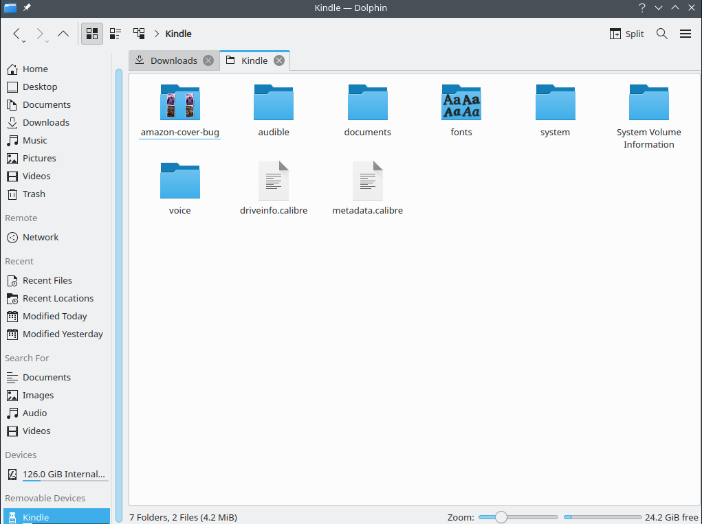

I'm posting some snips from a Tumbleweed virual machine. One shows the Kindle device as mounted in the file manager and the other is the text output from running calibre-debug -d (wrapped in spoiler to keep the message easier to read). This shows the 0x1949 vendor ID from Lab126 who are responsible for the Kindle ereader firmware.
localhost:~ # calibre-debug -d
calibre 5.30  embedded-python: True is64bit: True
Linux-5.14.11-1-default-x86_64-with-glibc2.2.5 Linux ('64bit', 'ELF')
('Linux', '5.14.11-1-default', '#1 SMP Sun Oct 10 08:34:34 UTC 2021 (834dddd)')
Python 3.8.5
Interface language: None
USB devices on system:
[['0xe0f', '0x3', '0x103', 'VMware', 'VMware Virtual USB Mouse', ''],
 ['0x1949', '0x324', '0x401', '', 'Internal Storage', 'G000xxxxxxxYYY'],
 ['0xe0f',
  '0x8',
  '0x100',
  'VMware',
  'Virtual Bluetooth Adapter',
  '000650268328']]
No disabled plugins
Looking for devices of type: MTP_DEVICE
No MTP devices connected to system
Looking for devices of type: SMART_DEVICE_APP
All IP addresses {'lo': [{'addr': '127.0.0.1', 'netmask': '255.0.0.0', 'peer': '127.0.0.1'}], 'ens33': [{'addr': '192.168.232.132', 'netmask': '255.255.255.0', 'broadcast': '192.168.232.255'}]}
No device is connected
Looking for devices...
USBDevice(busnum=1, devnum=2, vendor_id=0x1949, product_id=0x0324, bcd=0x0401, manufacturer=, product=Internal Storage, serial=G000TxxxxxxxYYY)
                Detected possible device KINDLE2
Devices possibly connected: Kindle 2/3/4/Touch/PaperWhite/Voyage Device Interface,
Trying to open Kindle 2/3/4/Touch/PaperWhite/Voyage Device Interface ...
Found device nodes: /dev/sdb None None
Syncing cover thumbnails to workaround amazon cover bug
Restored 0 cover thumbnails that were destroyed by Amazon
OK
Main memory: '/run/media/david/Kindle/'
Total space: (29315375104, 0, 0)
Hope this is of some help to you.
Edit: From a terminal session, try running df and see if it shows your Kindle. for me it shows as:
Filesystem 1K-blocks Used Available Use% Mounted on
/dev/sdb 28628296 3217512 25410784 12% /run/media/david/Kindle

Thanks David. I was using the wrong cable and the kindle was not mounting on the linux system. works now. Thanks for the education.
Lloyd
