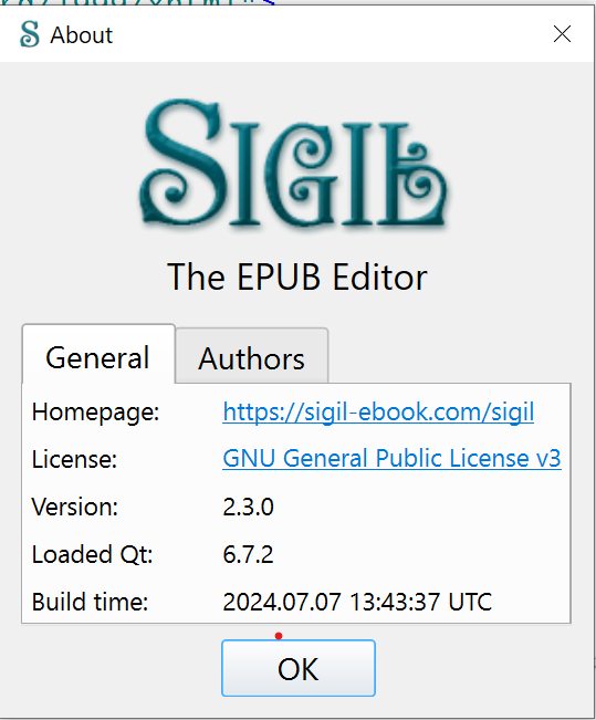

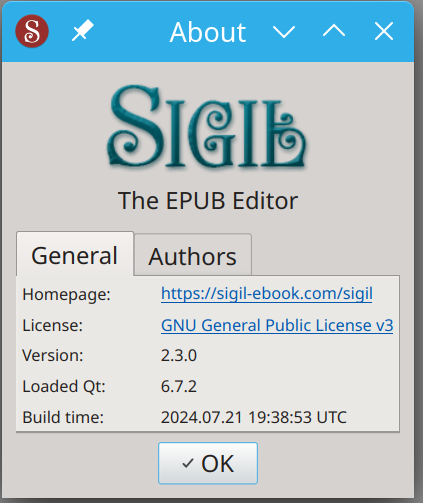

What does the About Sigil dialog say on both (exactly). A screen shot of each About box would help.

The 2.3.0 source was downloaded as Sigil-master.zip from https://github.com/Sigil-Ebook/Sigil
after I queried the name on the first download from your site which was named BuildSigilOnMac-for_sigil_1.0.0.zip which didn't seem appropriate.
Screenshots attached as requested:
ID:	210491   Click image for larger version

You built Sigil on Linux from beta 2.3.0 code. The final version was not released until just 2 weeks ago.
So you need to either download the official source from the releases on github, or just use today's master, not a copy of master from July.
Todays master would be best as it has a few bugs fixed.
Yes, I built the linux version way back on 21st July. I'll rebuild when I've a moment.
I just downloaded the Windows version again and re-installed. The warning message with Diatsu's epub doc is now the new one.

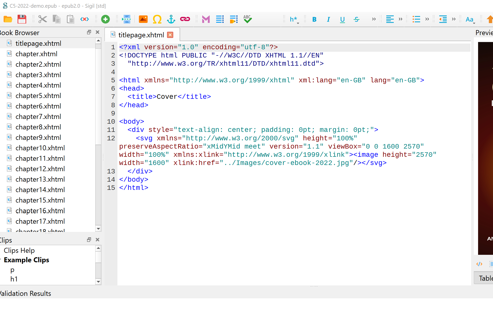

Just hopped back to the W10 box to check your suggestion re: qtwebengine's hardware accelerator and what did I find ?
After restarting Sigil, I disabled the qtwebengine's hardware accelerator. We'll see what happens over the next few days.
