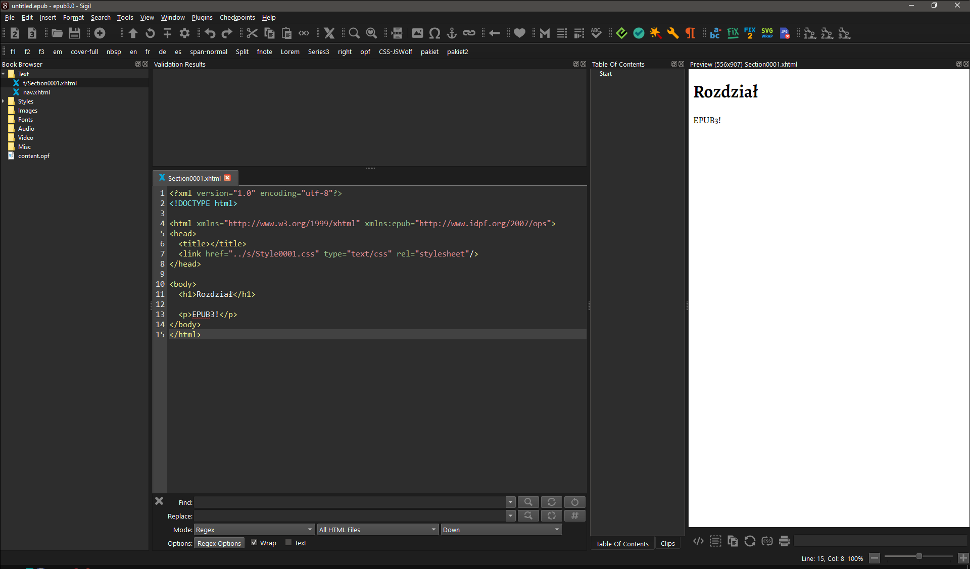

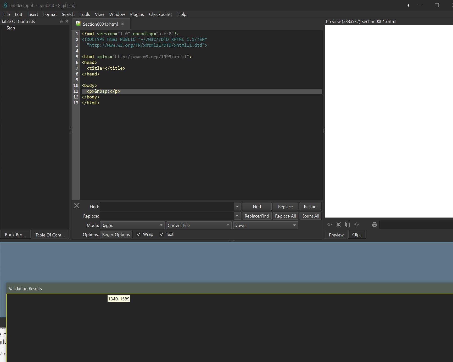

I'm puzzled as to how you docked the Validation and ToC windows where you did - above Codeview and alongside Preview. I've attached some screen shots of my failed attempts.
Name:	Screenshot 2024-04-16 081144.jpg
ID:	207659   Click image for larger version
Name:	Screenshot 2024-04-16 081734.jpg
