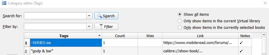

Doh, I assumed a ✔ in Manage Categories was a signal that a note for the item existed, for some explicable reason it didn't twig that I could tab to the cell and press F2 to enter/edit the item's note (just as I can for a link)
For info, a first implementation used buttons that was more explicite button, but drop du to perfomance issue.
To Kovid, that was possible to implemente a unique button as a cell (button of we modified properties dynamically according to the note it represents), or that is still to much bad regardless the perfomance?
There were two performance problems:
  • creating many thousand pushbuttons in Qt is slow. Each cellWidget had 3. A user-provided test library had 36,000 author rows, or 100,000 buttons.
  • cellWidgets are themselves very slow. I had read about that problem when doing the initial implementation but didn't test with a library big enough to run into the problem. Doing the beta fixed that oversight.
The performance problems can in theory be eliminated by using a styledItemDelegate instead of cellWidgets and drawing the buttons instead of creating button widgets. However, that seems to require writing the delegate in C++, which requires rebuilding calibre's binary for every test. This wasn't something I wanted to try.
Kovid's "checkbox" solution is performant, purely in python, and easy to understand. With a context menu offering create/edit, delete, import, and export (which exists) it works well enough.

One can add a tooltip to it saying press f2 to edit or whatever.
Tooltips in QTableWidgets don't work unless one implements mouse tracking. Switching to model/view would fix that, but ...
Another way to "fix" this is to use an "is editable" icon, perhaps edit_input.png. It could go on non-edited cells, just as the "Edited" (quill) icon goes on edited cells. Something like this:

Suggestion: instead of presenting a list of category item values in the Manage categories drop down, could a checkbox option be added at the top of the Category editor (xxxxxx) dialogue — "Only show items for the selected book(s)". If multiple books is a bridge too far, make it 'selected book' and disable the option if multiple books are selected.
I thought about this for a while, trying and failing to figure out why it would be better than showing the items in Manage categories. Then it hit me -- if you are using the cover grid then there is no way to select the column and therefore no way to see the item values in the menu. Adding the selected books restriction into the dialogs works around that problem.
This is what I submitted to Kovid, leaving Manage categories showing the items if it can.
Suggestions :
  • replace the ✔ with a pencil to match what's in Book Details;
  • put tooltips in the Category editor headers - as per the Book list.

Suggestions :
The check mark is a character, which permits showing both the "edited" icon and the check mark. Only one icon can be applied to a cell, so if we use the pencil icon then we can't use the edited icon. The edited icon can't replace the checkmark because a deleted note is edited with no check. I suppose that someone could invent a set of icons to indicate the 4 states (empty not edited, empty edited, exists not edited, exists edited), but that is neither something I am good at nor want to do. Perhaps someone else is willing to take it on.
Headers in the Qt table widget don't support tooltips. As Kovid said a bit back, getting tooltips really requires switching to the equivalent model/view implementation as used for the book list, which is a huge amount of work.
