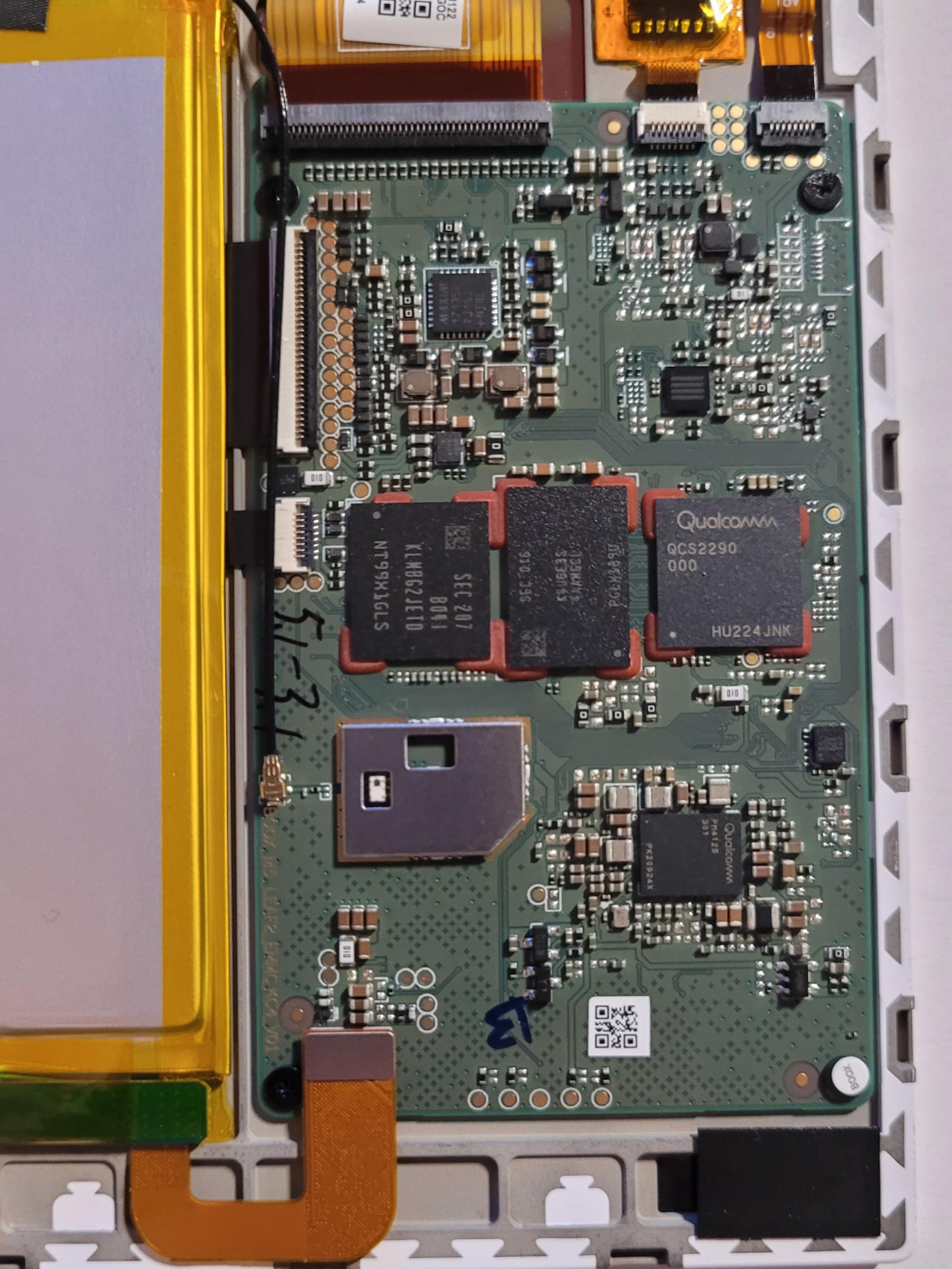

Old 12-06-2022, 02:12 PM   #81
denisuu
denisuu has learned how to buy an e-book online
denisuu's Avatar
Posts: 136
Karma: 98
Join Date: Dec 2018
Device: Onyx Leaf 2 (White)
The chip is a QCS2290 000
Name:	Leaf 2 - PCB.jpg
ID:	198235   Click image for larger version
denisuu is offline   Reply With Quote
Old 12-06-2022, 02:33 PM   #82
Renate
Onyx-maniac
Posts: 4,571
Karma: 22077803
Well, you've hit the Rosetta stone!
Now we know that a QCS_AGATTI is a QCS2290.
Here's one more Firehose loader to try: https://github.com/bkerler/Loaders/b...4665_FHPRG.bin
I'm confused over the two big FPC (orange) cables.
Onyx seems to be more secretive here. Still, the 5 dots on the bottom edge of the board look good for UART & EDL mode. Just don't short them!
Do you want to be a beta tester for a Leaf2 custom recovery?
Renate is online now   Reply With Quote
