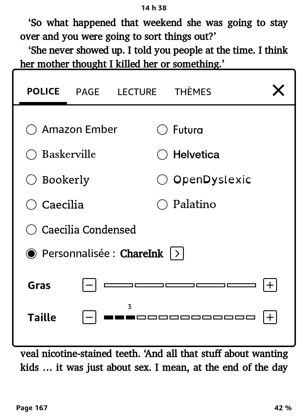

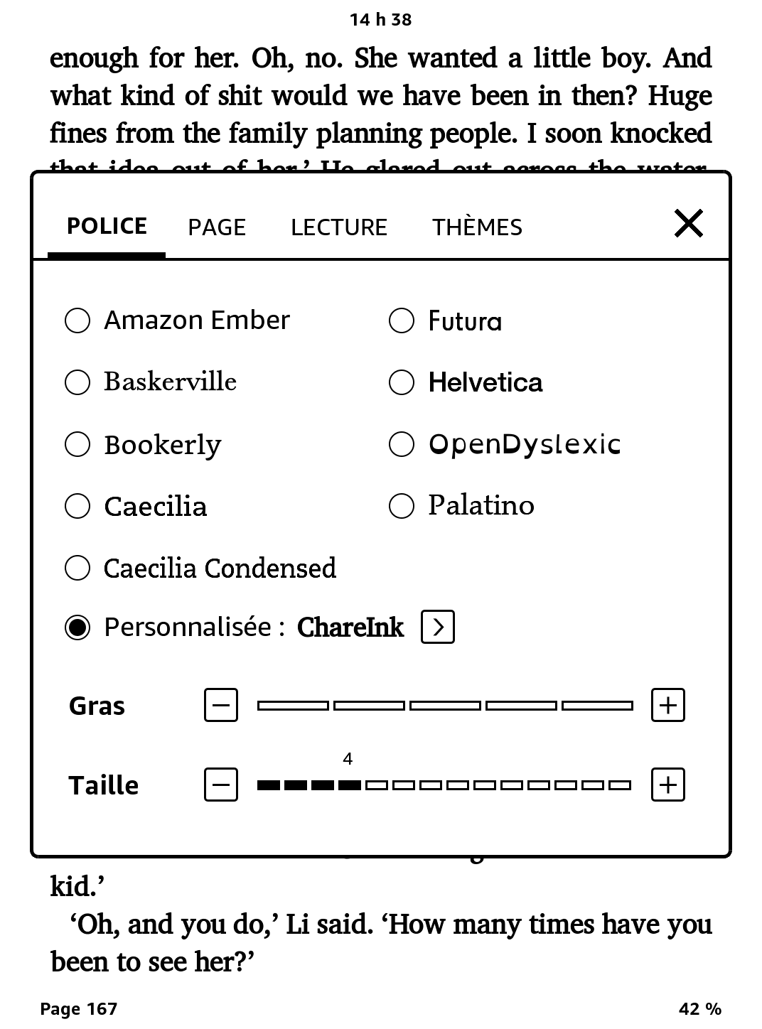

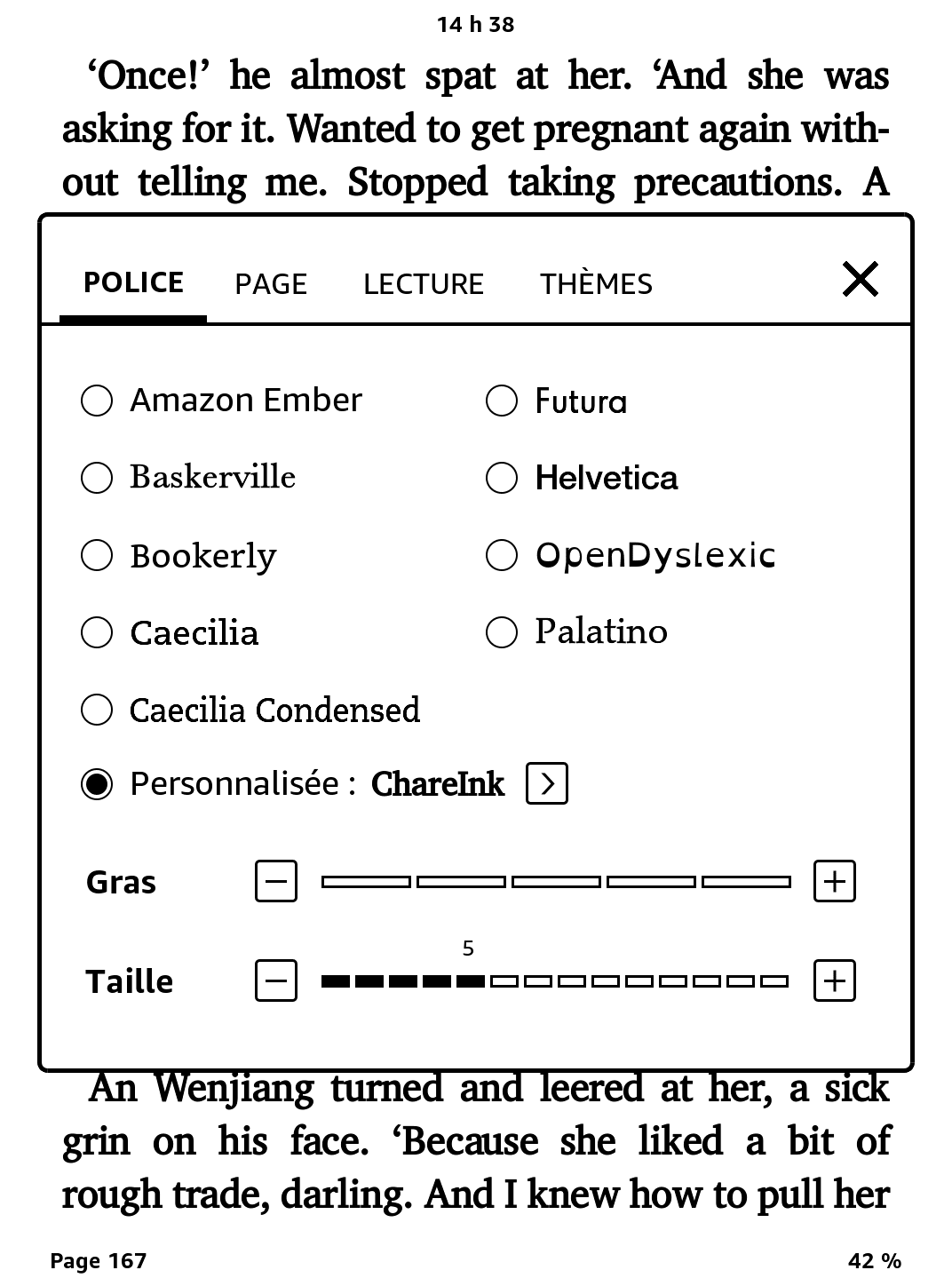

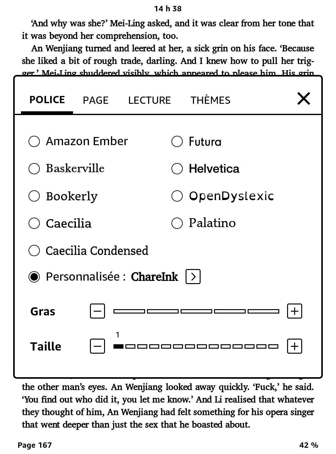

Using "ChareInk v1.1" at sizes 1 to 7:
ID:	176706Click image for larger version
ID:	176707Click image for larger version
ID:	176708Click image for larger version
ID:	176709Click image for larger version
ID:	176710Click image for larger version
ID:	176711Click image for larger version

@Jack426 and @Pop
Thank you for the information and screen grabs.
I don't know what's going on with Booklerly. ChareInk has no hinting as when it originally had hinting, someone said it looked better without hinting and it did for eInk. ChareInk looks quite good on a Kindle and the line height is a lot more reasonable (IMHO). Plus, you get more text per page with ChareInk then you do Bookerly. And no that I know ChareInk is working on 5.12.3, there's a Kindle PW3 I can update without worry about ChareInk not properly working.
