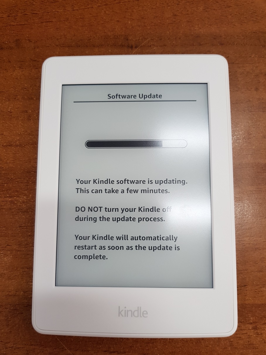

- I clicked the Update your Kindle option from Settings the device rebooted and after some time got this on the screen:
- I had to wait about 14 minutes, after that wait-time the device rebooted into the normal home screen; it flickered a few times in the process.

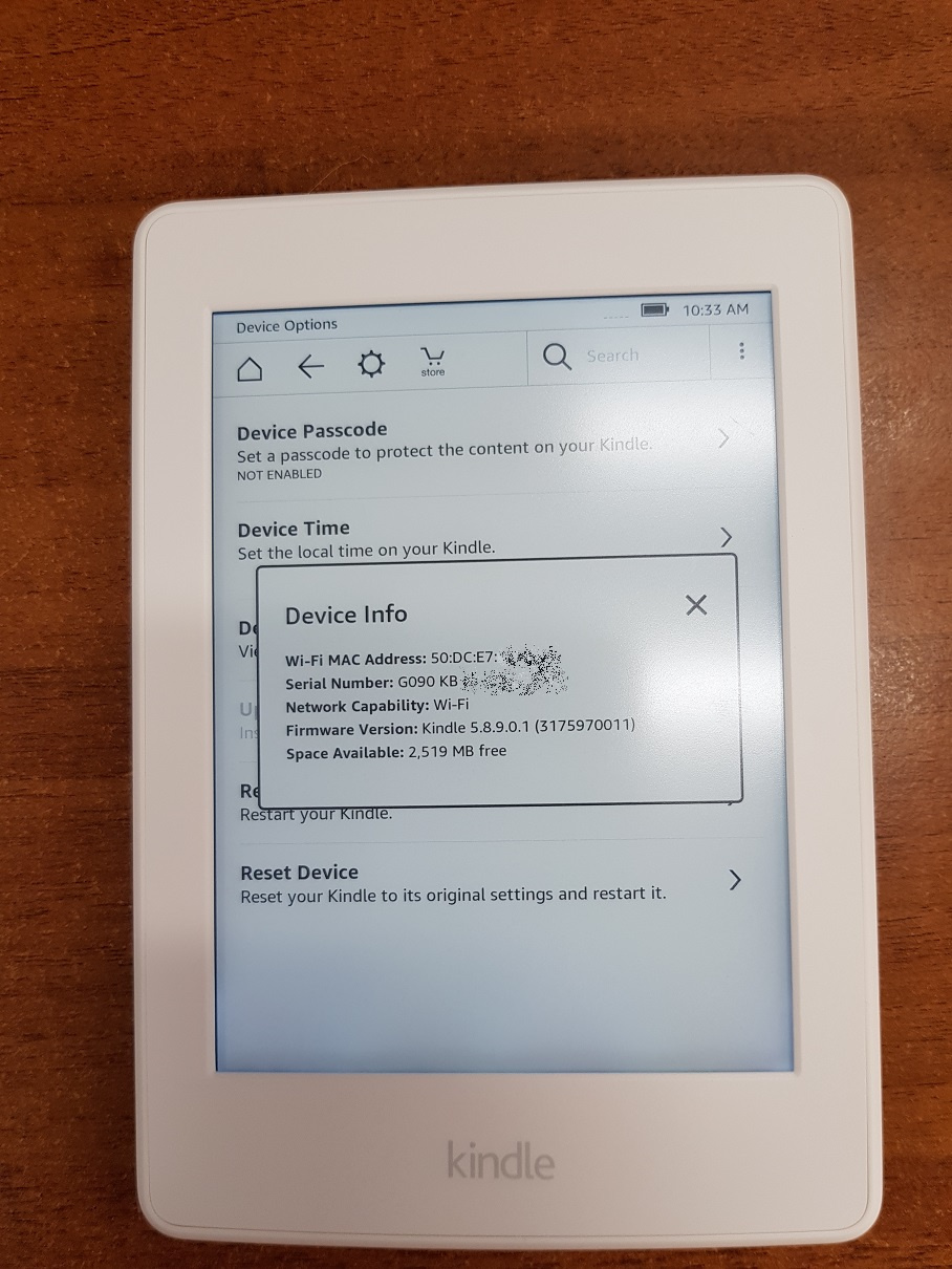

- Now, with the factory image of 5.8.9.0.1 installed I have those details:

First off let me admit I know absolutely nothing about Kindles, however, your second image is displaying your full serial number. People are generally advised here not to do this. Perhaps you need to edit the image and reattach. I don't know whether MAC addresses are similarly advised to be kept private.

@jackie_w: Thanks, I'd only caught the plaintext one in the body of the post .
(Also, before you get mobbed by a green mod, guidelines for inline images state 600x600 as the maximum allowed dimensions, so I thumbnailed 'em too ).
