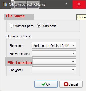

@Terisa de Morgan - I am totally & utterly confused, you tell me here I have the PI wrongly configured, yet you issue a new release to correct the problem I reported.
A 'file path' by definition includes its location, if the column specifier called File Path now means the File Location you should give it a new label.
I am 99.99% certain that the way I had it (see attachment 2 in post #71) worked up until Dec 24. I have hundreds of books added before that date that are OK. I am 99.99% certain I didn't change the PI configuration on that date, but I did install version 0.0.7 on that date.
The way I had it configured made sense semantically. IMO asking for 'file path' and then putting the column name in a variable called 'file name' when there's another variable called 'file path' is somewhat bizarre/weird, perverse even
If the current purpose of the File Path column specifier is to specify the File Location I suggest the configuration dialogue be changed accordingly - see attachment.
For aesthetic reasons I would also swap the Without Path and With Path radio buttons. Or, better yet replace them with a "Put full file path in File Name column: " check box. IIRC the best practice UI convention is to use check boxes for either/or choices, and radio buttons when there are between three and seven options to choose from. I appreciate why you might not want to do this.
Not for me
Not really. I'm requesting if the file name includes path and the tip in file path says: It stores the file path. If not included, the file name is not split.
I disagree in this, sorry. BTW, on my commute this morning I thought a bit and I expected this comment
Well, I like your suggestion for this but.. it's not right because, if you fulfill path and name column, the name column doesn't include the file path

Terisa de Morgan, What you regarded as a bug was for me an established, rational behaviour that did what I wanted.
Prior to the bug fix, the configuration shown below was allowed, and it produced a verifiable result - i.e. the full path was put into the column specified in File Path
But since the bug fix, that configuration is still allowed, but it produces no result - i.e. nothing is put into the column specified in File Path.
In my book that's a bug. If the configuration is invalid (because there's no column specified for File Name) then the PI should issue a message when a Book is added and abort the add. If it's not invalid then it should produce a verifiable result - such as putting the file location (path without filename & extension) into the specified column. Anything, except do nothing.

I totally agree, it's a configuration bug I'll try to correct in a new version (extension and path will be disabled till name is fulfilled).

Added 0.0.10 version => It shows not allowed configurations. It doesn't remove the previously configured columns, that doon't work.
