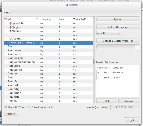

@brolny
I won't be doing anything with fonts, alas .
For the word column width problem a simple resizing of the SpellcheckEditor window should suffice. For the problem with the width of "Change Selected Word To" box I will try to implement ToolTip (when you place your mouse on the object a text in a box will appear): it's not perfect but will help some, I think - see picture.
I would like to have a sample of your book, just a page with this long word would be enough. What language is this?

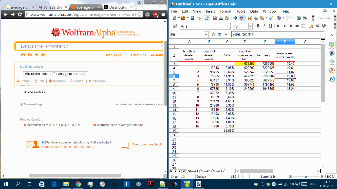

According to this (http://www.wolframalpha.com/input/?i...sh+word+length) - the average length of English word is 5, Armenian is 16, Russian is 15, German and Spanish is 14.
But I think that it's wrong, so I make a 5-minutes calculation on words in Armenian Bible. Average word's length is >10, but without auxiliary verbs and pronouns (article is the part of a word, and written together with the word) the length is ~13 chars. So, it's seems to be true...
Three times more! Unbelievable.
But main noise/disadvantage not the length itself, but the letters - some letters combinations very very hard now to recognize in suсh small size...
So it's complicated - width of editable field + length of words + letters combinations + font style...

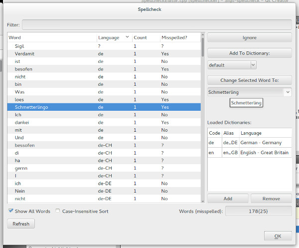

You have a lot of work ahead of you with them: the languages are not properly tagged - see picture (ur3.epub).
And then you use "ru-RU" as "dc:language" and just "ru" in overriding html xml:lang attribute.
That reminds me: I wanted to do something general with "ln" versus "ln-LN" since (almost) the very beginning - but I get heavily distracted with other issues on this project...
