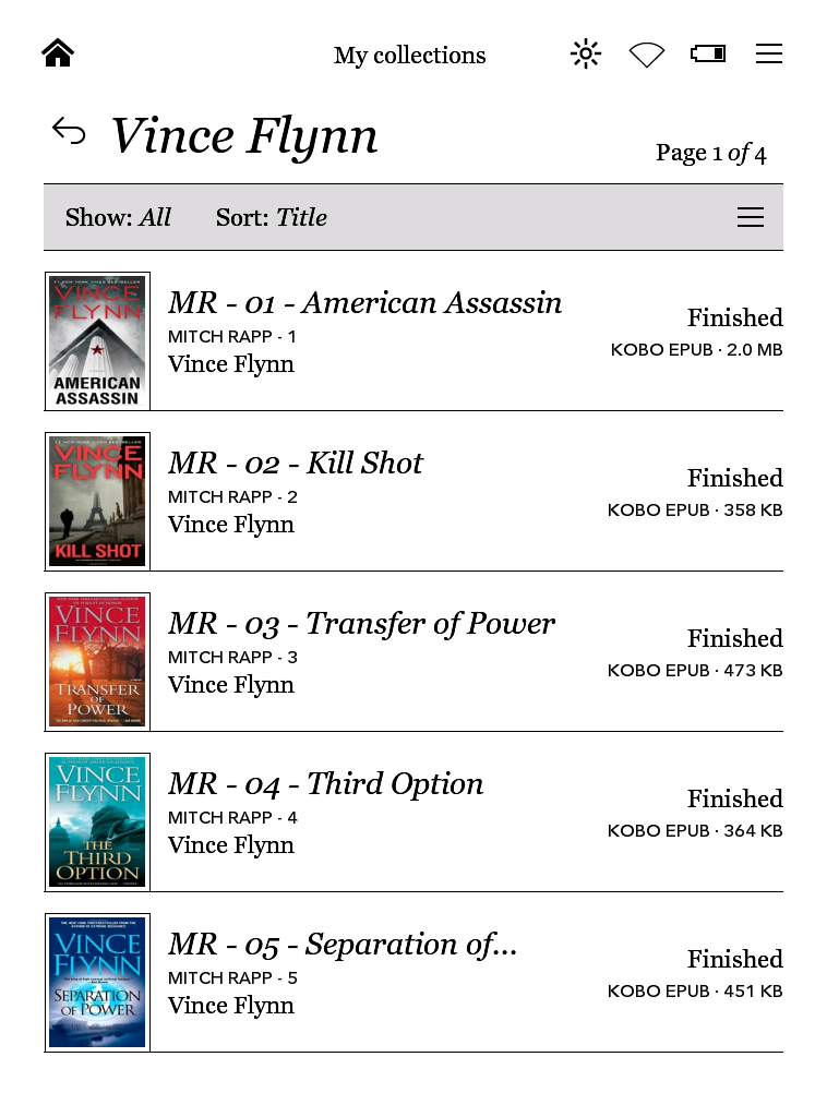

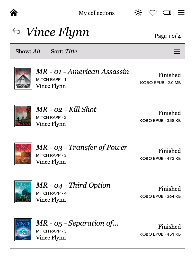

Patch `Increase The Books Cover Size In The Library`
Firmware 4.2.8810+, the patch is integrated in GeoffR patcher, nickel.patch.
Firmware 4.1.7729: nickel.patch, See CSS nickel patch.

Multi-version patch: 3.15.0-3.19.5761+: libnickel.so.1.0.0.patch.
<Patch>
patch_name = `Increase The Cover Size In Library`
patch_enable = `yes`
# Multi-version patch: 3.13.1-3.19.5761+
find_base_address = `DragonListWidget[qApp_deviceIsTrilogy="true"] {\n\tmin-height: 115px;`
#Mini
replace_string = 0059, `min-width: 534px;`, `min-width: 536px;`
replace_string = 006C, `max-width: 534px;`, `max-width: 536px;`
replace_string = 007F, `qproperty-leftMargin: 12;`, `qproperty-leftMargin: 00;`
#Glo\Aura
replace_string = 00E5, `min-width: 678px;`, `min-width: 693px;`
replace_string = 00F8, `max-width: 678px;`, `max-width: 693px;`
replace_string = 0133, `qproperty-leftMargin: 15;`, `qproperty-leftMargin: 00;`
#Aura HD\H2O
replace_string = 0198, `min-width: 960px;`, `min-width: 980px;`
replace_string = 01AB, `max-width: 960px;`, `max-width: 980px;`
replace_string = 01FE, `qproperty-leftMargin: 20;`, `qproperty-leftMargin: 00;`
find_base_address = `#coverPixmapView {\n\tmin-width: 60px;`
#Mini\Touch
replace_string = 0014, `min-width: 60px;`, `min-width: 85px;`
replace_string = 0026, `max-width: 60px;`, `max-width: 85px;`
replace_string = 0038, `min-height: 90px;`, `min-height:105px;`
replace_string = 004B, `max-height: 90px;`, `max-height:105px;`
#Aura HD\H20
replace_string = 0090, `min-width: 90px;`, `min-width:130px;`
replace_string = 00A2, `max-width: 90px;`, `max-width:130px;`
replace_string = 00B4, `min-height: 140px;`, `min-height: 163px;`
replace_string = 00C8, `max-height: 140px;`, `max-height: 163px;`
#Glo HD
replace_string = 010F, `min-width: 100px;`, `min-width: 145px;`
replace_string = 0122, `max-width: 100px;`, `max-width: 145px;`
replace_string = 0135, `min-height: 160px;`, `min-height: 205px;`
replace_string = 0149, `max-height: 160px;`, `max-height: 205px;`
#Glo\Aura
replace_string = 0190, `min-width: 70px;`, `min-width:104px;`
replace_string = 01A2, `max-width: 70px;`, `max-width:104px;`
replace_string = 01B4, `min-height: 110px;`, `min-height: 140px;`
replace_string = 01C8, `max-height: 110px;`, `max-height: 140px;`
</Patch>
version patch: 3.13.1: libnickel.so.1.0.0.patch.
<Patch>
# version patch: 3.13.1
#Mini
replace_string = 0059, `min-width: 512px;`, `min-width: 524px;`
replace_string = 006C, `max-width: 512px;`, `max-width: 524px;`
#Glo\Aura
#Aura HD\H20
#Mini\Touch
#Aura HD\H20
#Glo HD
#Glo\Aura
</Patch>
ID:	145592 Click image for larger version

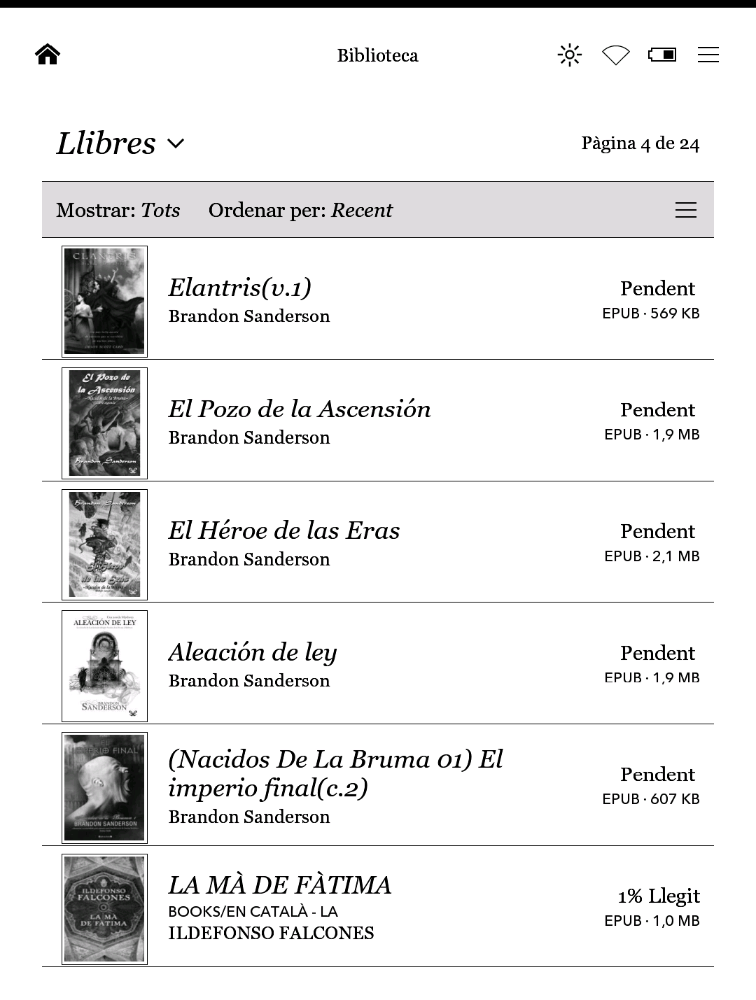

Originally Posted by oren64 View Post
Patch `Increase The Books Cover Size In Library`
In Touch\Mini\Aura HD\H2O, the changes are smaller.
wow! I like a lot!
EDIT: Best fit for my aurah2o:
<Patch>
patch_name = `Increase The Books Cover Size In Library`
#Mini\Touch
replace_string = 0014, `min-width: 60px;`, `min-width: 70px;`
replace_string = 0026, `max-width: 60px;`, `max-width: 70px;`
replace_string = 0038, `min-height: 90px;`, `min-height: 99px;`
replace_string = 004B, `max-height: 90px;`, `max-height: 99px;`
#Aura HD\H2O
#Glo HD
replace_string = 010F, `min-width: 100px;`, `min-width: 140px;`
replace_string = 0122, `max-width: 100px;`, `max-width: 140px;`
replace_string = 0135, `min-height: 160px;`, `min-height: 200px;`
replace_string = 0149, `max-height: 160px;`, `max-height: 200px;`
#Glo
replace_string = 0190, `min-width: 70px;`, `min-width: 99px;`
replace_string = 01A2, `max-width: 70px;`, `max-width: 99px;`
replace_string = 01B4, `min-height: 110px;`, `min-height: 147px;`
replace_string = 01C8, `max-height: 110px;`, `max-height: 147px;`
</Patch>
surquizu is offline   Reply With Quote
Edit: I changed values.
<Patch>
#Mini\Touch
replace_string = 0038, `min-height: 90px;`, `min-height:112px;`
replace_string = 004B, `max-height: 90px;`, `max-height:112px;`
#Glo\Aura
#Aura HD\H20
#Glo HD
</Patch>
<Patch>
#Mini\Touch
#Glo\Aura
#Aura HD\H20
#Glo HD
</Patch>
Attachment 145592 Attachment 145595
That's a nice improvement on the looks and feels! Thanks Oren64 and surquizu, for the great work!
