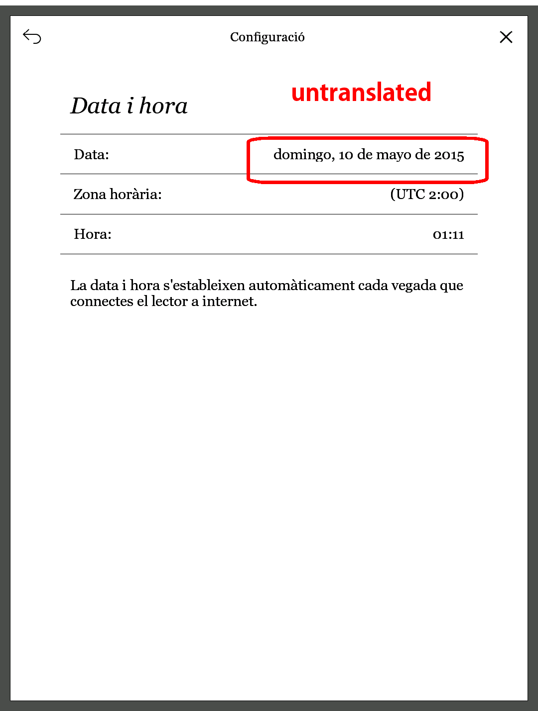

Originally Posted by tshering View Post
Could you point me to an example? First I thought you mean for instance 1/23/15 against 23/1/15. But now I think you mean something else.
See images attached 1 and 2.

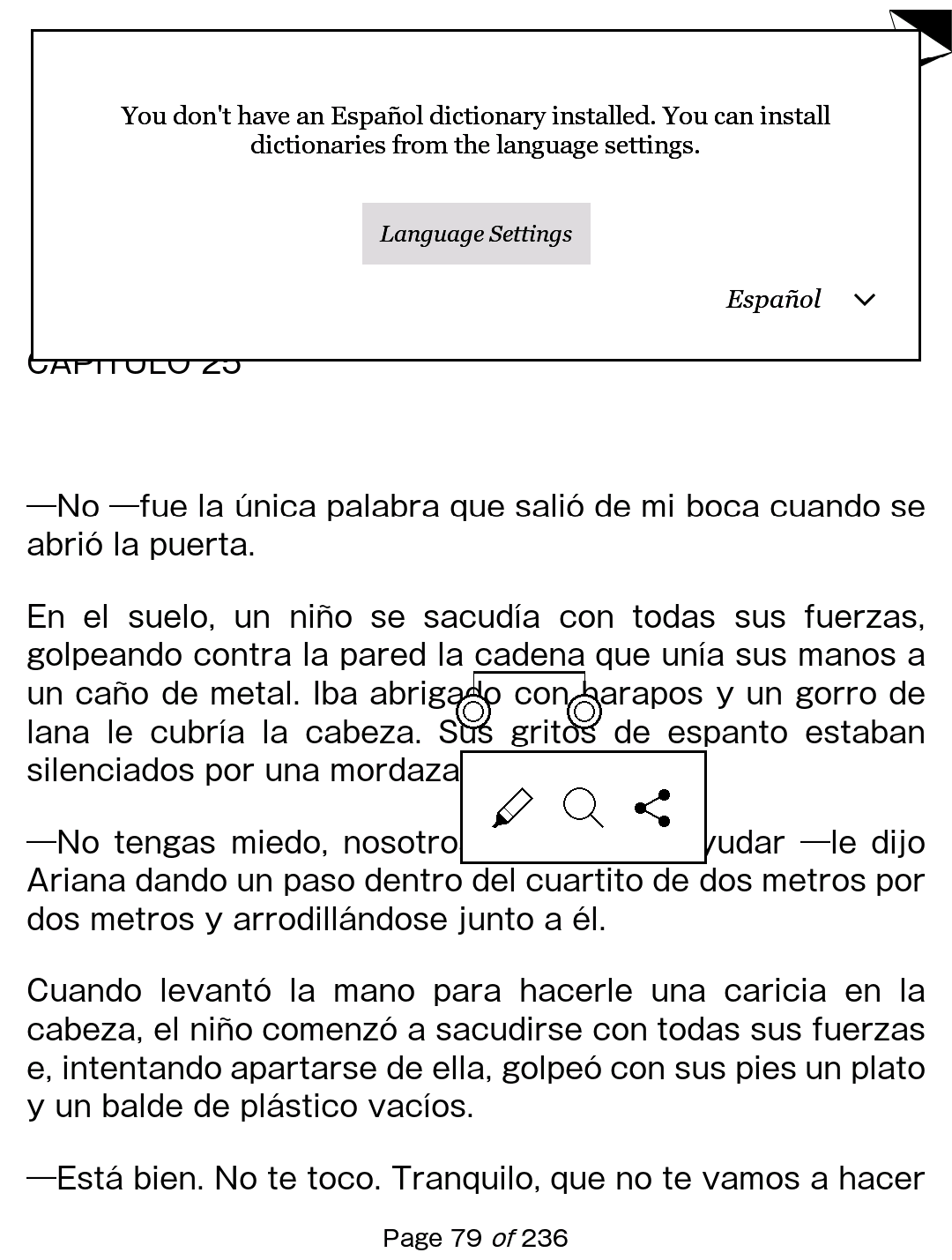

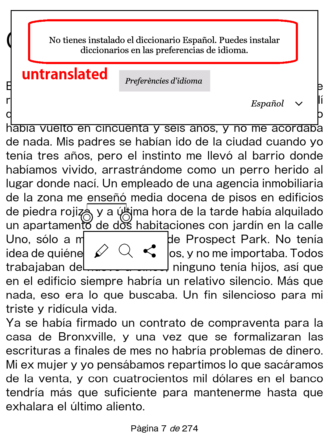

I see three strings related to this topic.
DictionaryEmptyState{ref}You don't have the %1 dictionary installed. To add one to your eReader, tap Manage Dictionaries.{tr}No tens instal·lat el diccionari %1. Per afegir-lo al lector, prem Administrar diccionaris.
DictionaryEmptyState{ref}You don't have the %1 translation dictionary installed. To add one to your eReader, tap Manage Dictionaries.{tr}No tens instal·lat el diccionari de traducció %1. Per afegir-lo al lector, prem Administrar diccionaris.
InlineDictionaryView{ref}You don't have a %1 dictionary installed. You can install dictionaries from the language settings.{tr}No tens instal·lat el diccionari %1. Pots instal·lar diccionaris en les preferències d'idioma.
Are you saying that those strings do not have an effect? Or are you talking about another message?

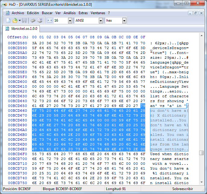

These three strings and other about dictionaries on are well translated. The string untranslated is the image attached No. 3 (image No, 4 is the same in English).
I see this text string and others strings in libnickel.so.1.0.0 (BCD65F v.3.15.0) but no in spanish.

The dates are probably coming from the standard libraries. Try setting the locale in the config file to something appropriate for your country and language. Look for "CurrentLocale" in the config file and change the value. From what I can see, the value should be "ca_ES".

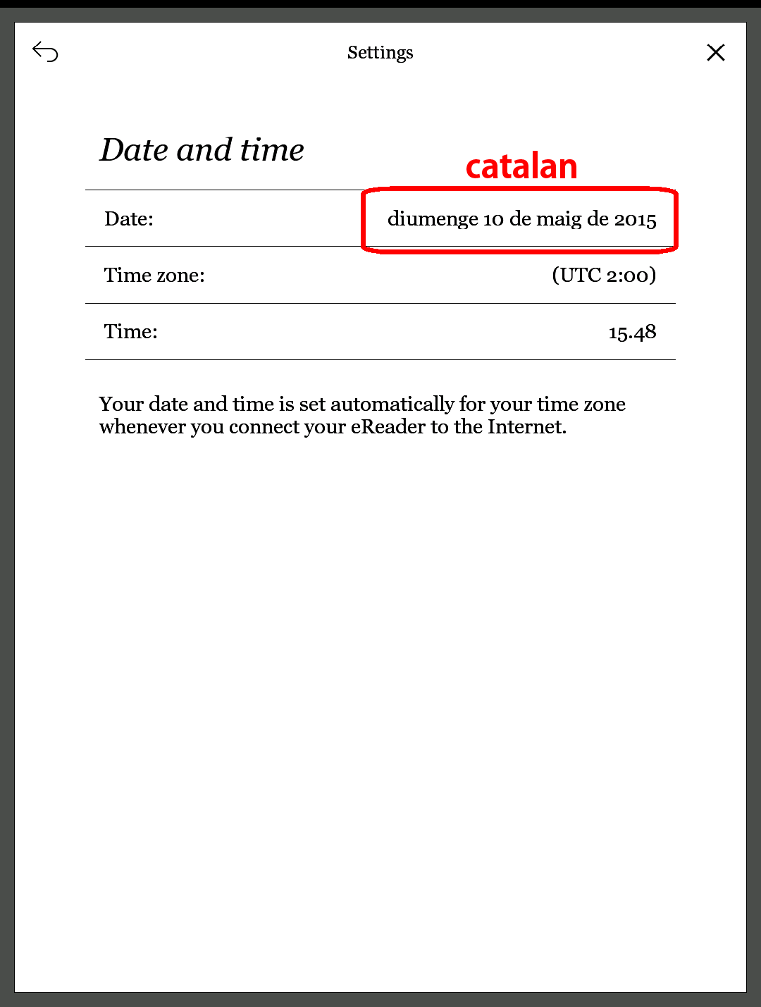

Very nearly. With ca_ES, the date is translated to Catalan, but disappears the rest of translation and placed in English. If I apply again the Spanish language (translated into Catalan) the date is again untranslated.
I missed this one. Here it is.
InlineDictionaryView{ref}You don't have an %1 dictionary installed. You can install dictionaries from the language settings.{tr}No tienes instalado el diccionario %1. Puedes instalar diccionarios en las preferencias de idioma.
The text string is well translated, I do not understand why the translation is not seen in the reader. Luckily is little important, don't worry.
No, it is not yet translated, because I overlooked this string for some reason.

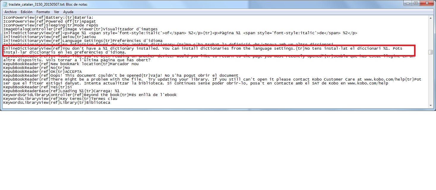

But it is in the file of translations...
Look, there is a small difference: "a %1 dictionary" against "an %1 dictionary". I think the Catalan translation can remain the same in both cases. Right? I will inserted this string, and upload the zlib file in the evening when I am back home.
