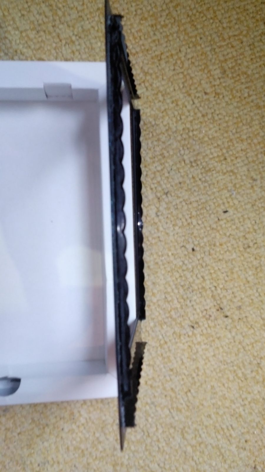

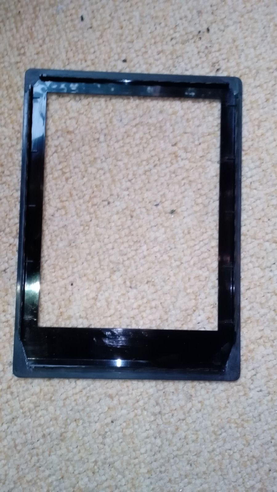

Yeah, the screen itself hardly can be the cause.
This is how my bezel looks after some cleaning and rubbing the glue and adhesive stips off.
Look okay to me. Could this still be the cause for IR-problems (only pressing it down for testing, so not yet glued again ofcourse).

Your touchscreen problems started even before taking it apart, right?
So that point alone makes a problem with the mainboard more likely...
I don't have anymore ideas here, sorry.

Well, now I'm doubting everything, only making things worse along the way. I've 'cleaned' the surface of the screen with som 'Jif-like' (here in the Netherlands it's called Jif, also used to clean kitchen toppings, I guess very fine sand particles in there for some grinding effect), I did some cleanng of the screen and bezel in the past also ... Nothing strange to see after visual inspection again.
I only will find out when I have a second copy of the H2O and can do some more testing and exchanging.
If anyone of the readers here has a broken H2O: I'm interested and will buy it cheaply for the sake of science haha.
Eek!
Only clean with soft stuff. I use a LCD cleaner (brand rogge/ronol) with soft cloth.
The light layer is very sensitive to scratches, if it's damaged in any way once you turn the light on it will glare...
