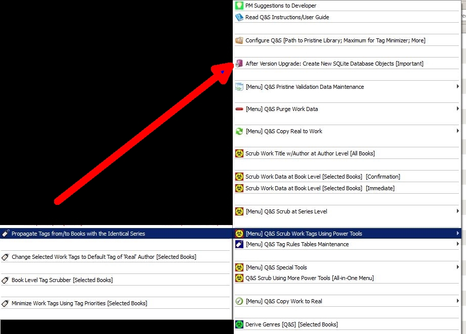

Version 3.6.6 -26 January 2015 New Database Version 4.3.0
Please run the "After Version Upgrade" job near the top of the main Q&S menu to update your Q&S library metadata.dbs to the latest version.
This version makes changes to a SQLite view used in the "Propagating Work Tags from/to All Books With Identical Work Series" job.
DaltonST

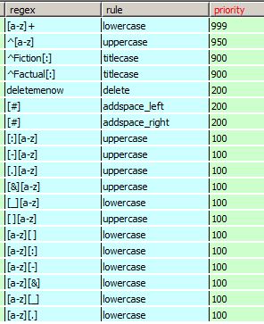

Version 3.6.7 New "Tag Capitalization Rules" User Maintained Table
Version 3.6.7 New "Tag Capitalization Rules" table, which is user maintained; Revised User Guide; New DB Version 4.4.0.
Please refer to Page 53 of the User Guide for details.
Also, you must run the "After Version Upgrade" job near the top of the Q&S main menu; otherwise, your jobs will fail because the new table, _tag_capitalization_rules, will not exist (yet) when they try to use it.
You own this table once it has been created, and the seed entries (shown in the User Guide on Page 53 and in the attached image) have been created.
If you use BISAC-like Tags, you will instantly grasp the utility of these seed entries.
Example: “Factual:History:War&Military-World War II-North Africa-Libya” would typically become “Factual:history:war&military-world war II-north africa-libya” if it were not for this functionality, although the _tag_rules table might get lucky first.
The priorities in this table work identically to the priorities in all of the other Q&S tables that use priorities.
The "Book Level Scrubbing", "Work Tag Scrubbing" and "Work Tag Minimization" functions use this table now.
