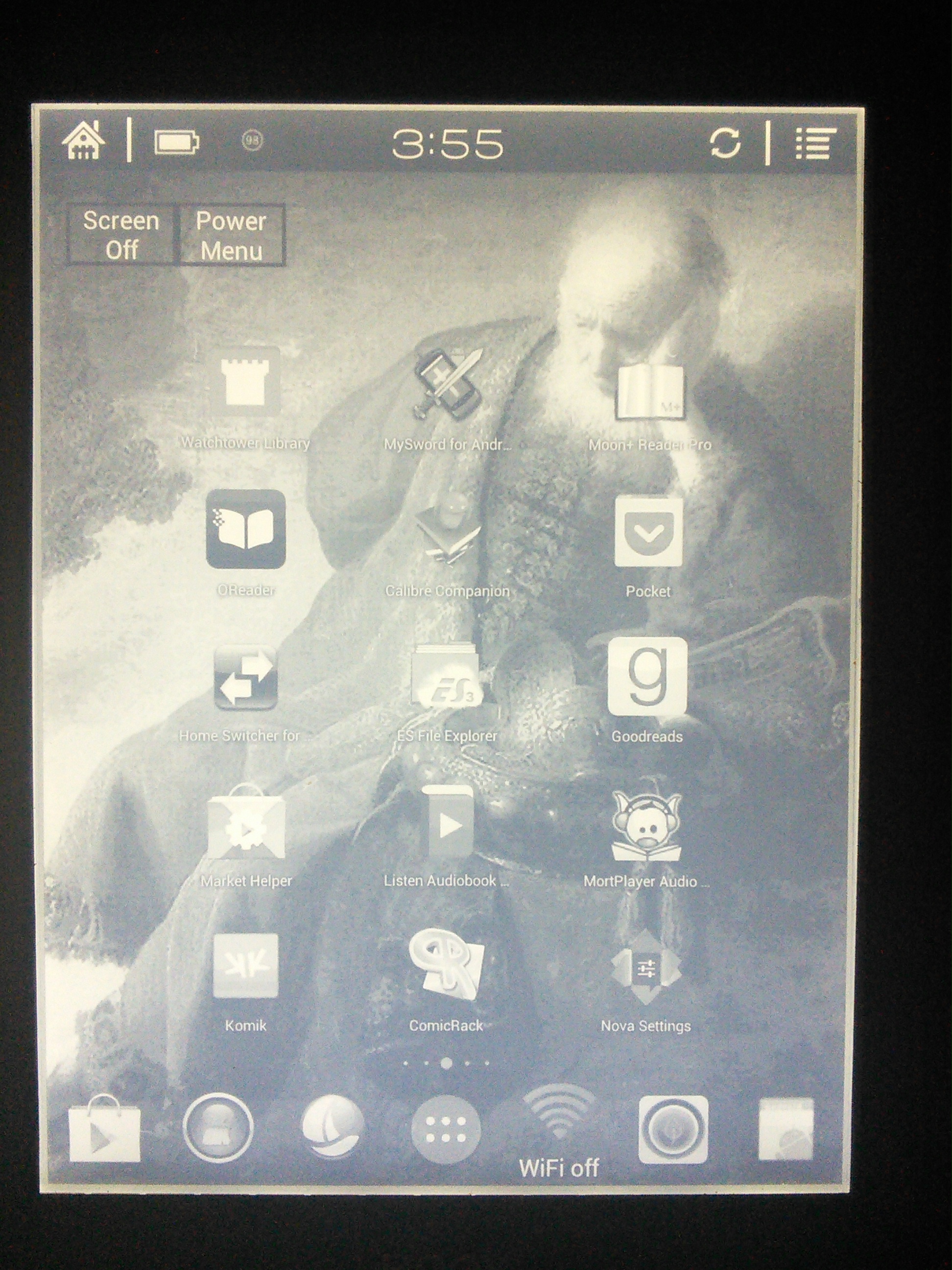

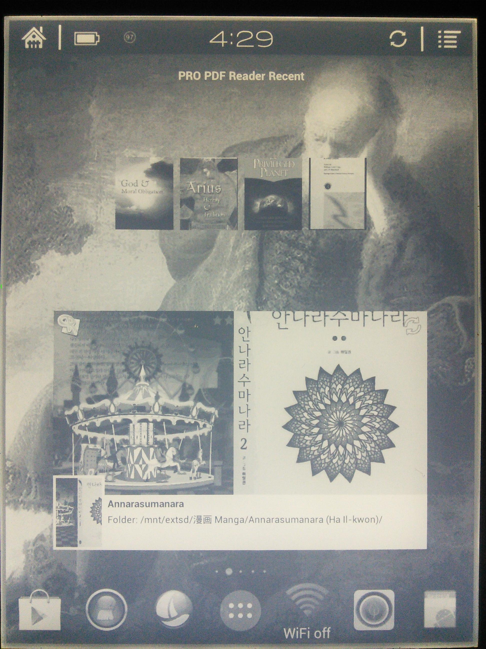

You have the Boyue T62? Nice, can you set it up as you can with the T68? Such as having Nova launchers, and other launchers. I've attached how I have my T68 set up, would this be able to replicated on the T62, and how is using a SD card with the T62. As I think it has the Android update that makes it harder to use the SD card with devices that don't have the Android 4.4 update.
ID:	129813   Click image for larger version
